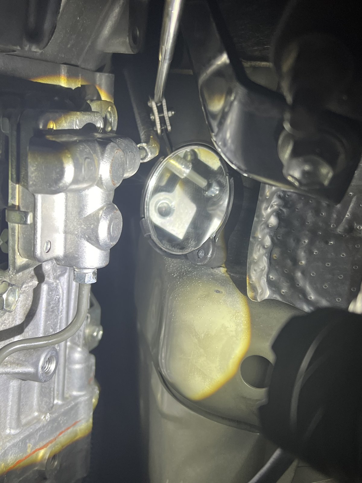

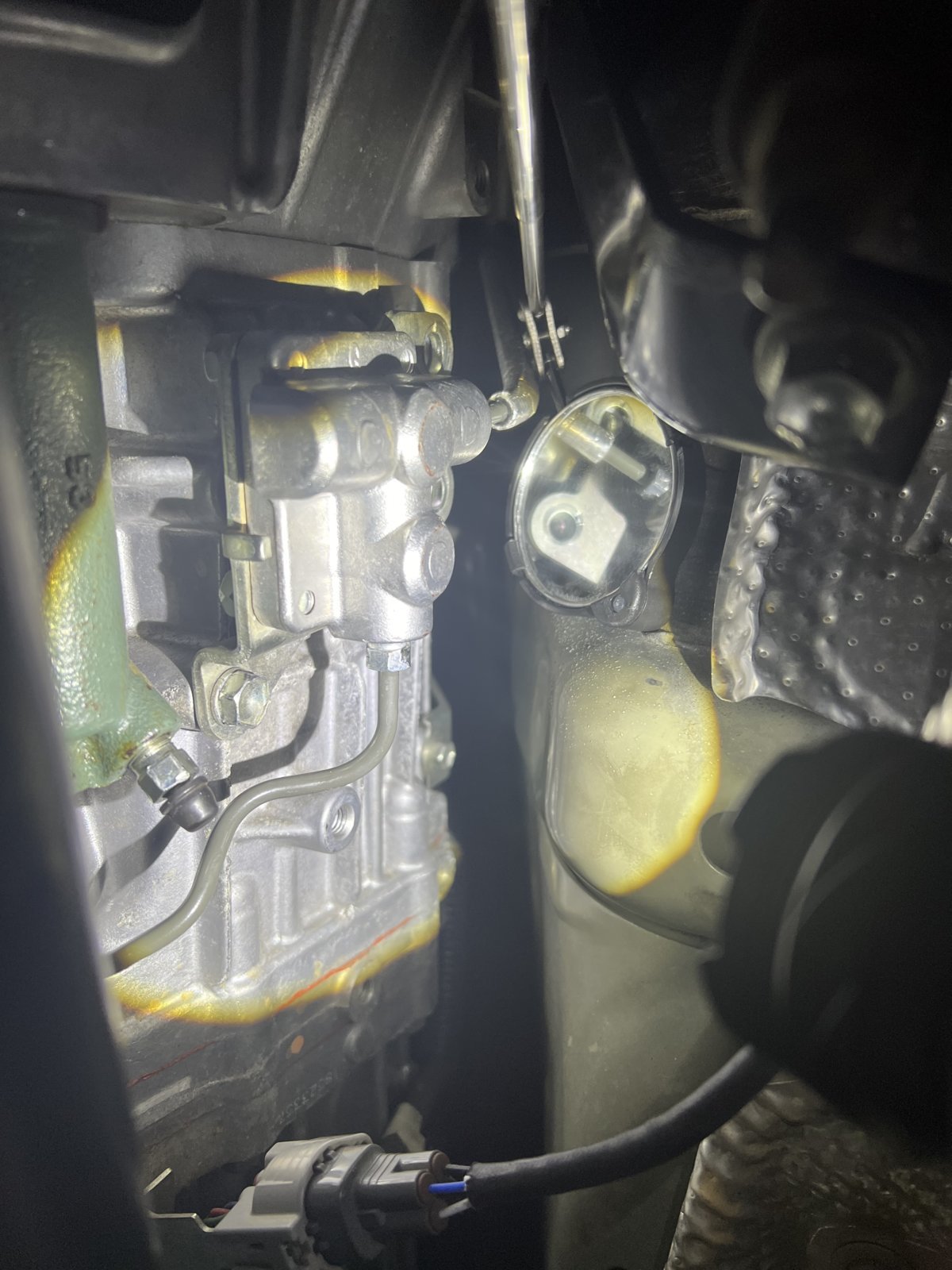

    So I just fucked up. While trying to do this job, I rounded off the nut going to the accumulator from the master cylinder . I can’t get the damn thing off.
    any ideas on how I can get it out without causing any major damage.

    Were you using a line wrench? If not, maybe you can still sneak one on the screwed up tube nut….if not, vise grips….

    Vice grips. The bigger the better.
    Whatever you do, do not use heat.

    Pulling the cat support is easier than getting to the top heat shield bolt and gives a lot more room to work.
    If you rounded the flare nut, I would not proceed unless you have everything needed to replace the line just in case. If it is boogered up and cannot be tightened well enough, that is where you will be stuck.
    Note that the line support on the trans is bolted on to the trans.
    Good luck.

    In the future, line wrench. Not vise grips or open end wrench for a good condition tube nut. Vise grips might be the only option at this point, though I’d try a line wrench first myself.

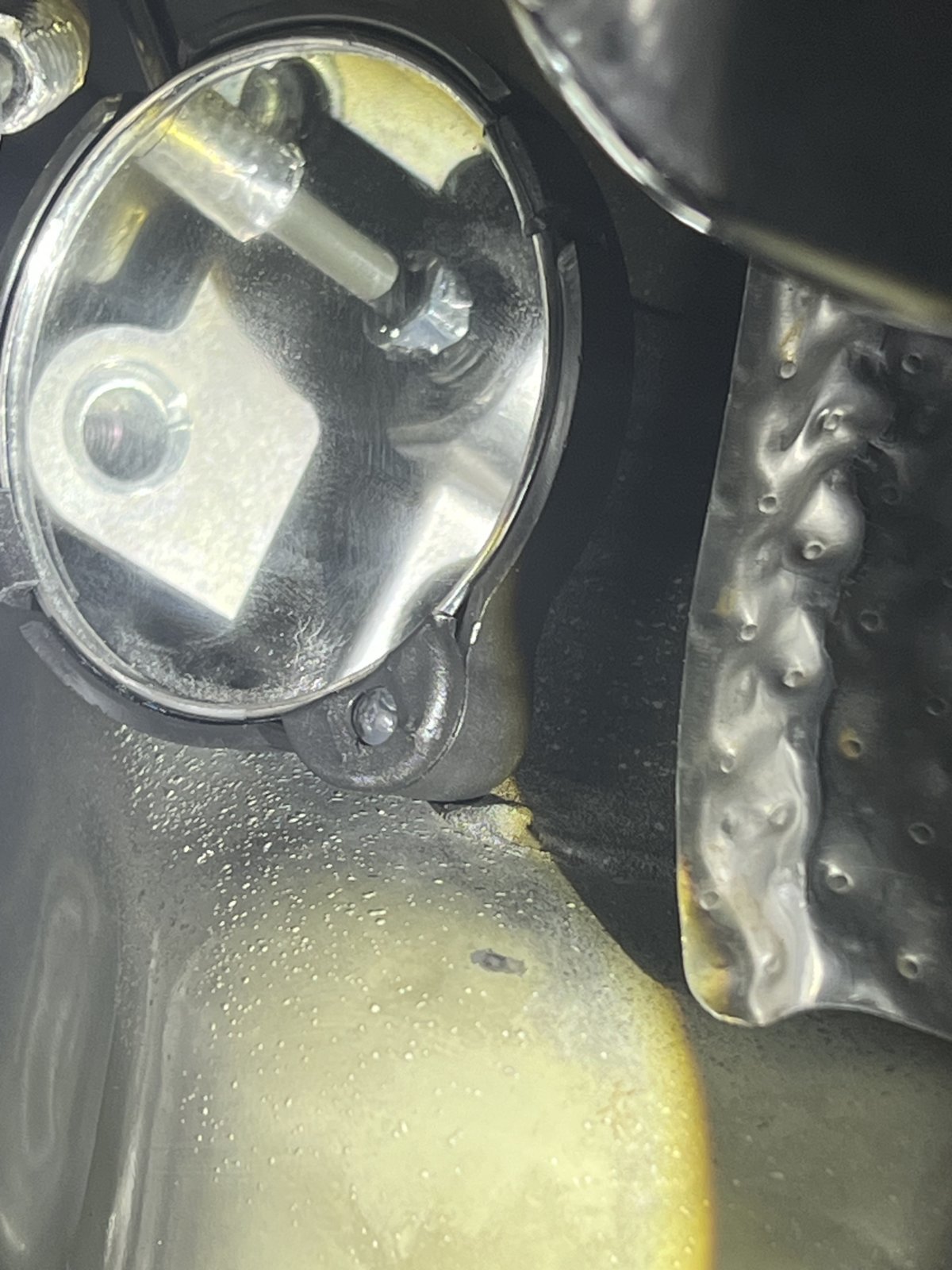

    since I rounded off the nut at the top of the accumulator. I don’t think I loosened it any. Is it normal for a bit of thread to be showing? Like in the pic I posted.
    I’m afraid of it leaking once I start filling it up again.

    Thread showing is normal, you should be perfectly fine. Make sure you are spinning the nut right direction also. Since it’s up above and facing downwards, it’s easy to get confused. With you laying underneath, it’s clockwise, aka righty loosy. Easy to screw it up if you’re trying to break it loose but actually going in the tightening direction.

    Flare nut crowfoot might be just the trick, not sure if you have room there for a conventional wrench (I’ve been getting them from Tekton lately and they fit tight, almost too tight…but better than the alternative). Good news is since you rounded it over with a conventional open end, you only knocked off 2 of your 6 corners! :)

    Those flare nut wrenches are dynamite. Double duty as brake line wrenches for when you eventually have to replace the hard lines from your calipers (not complicated)
