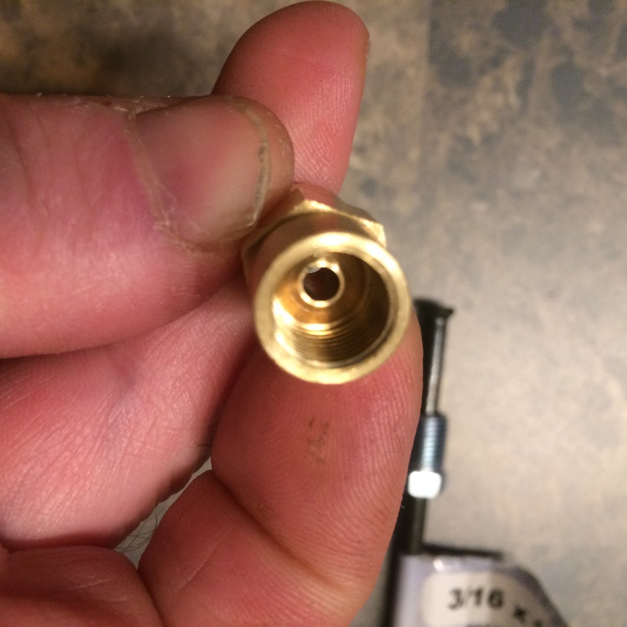

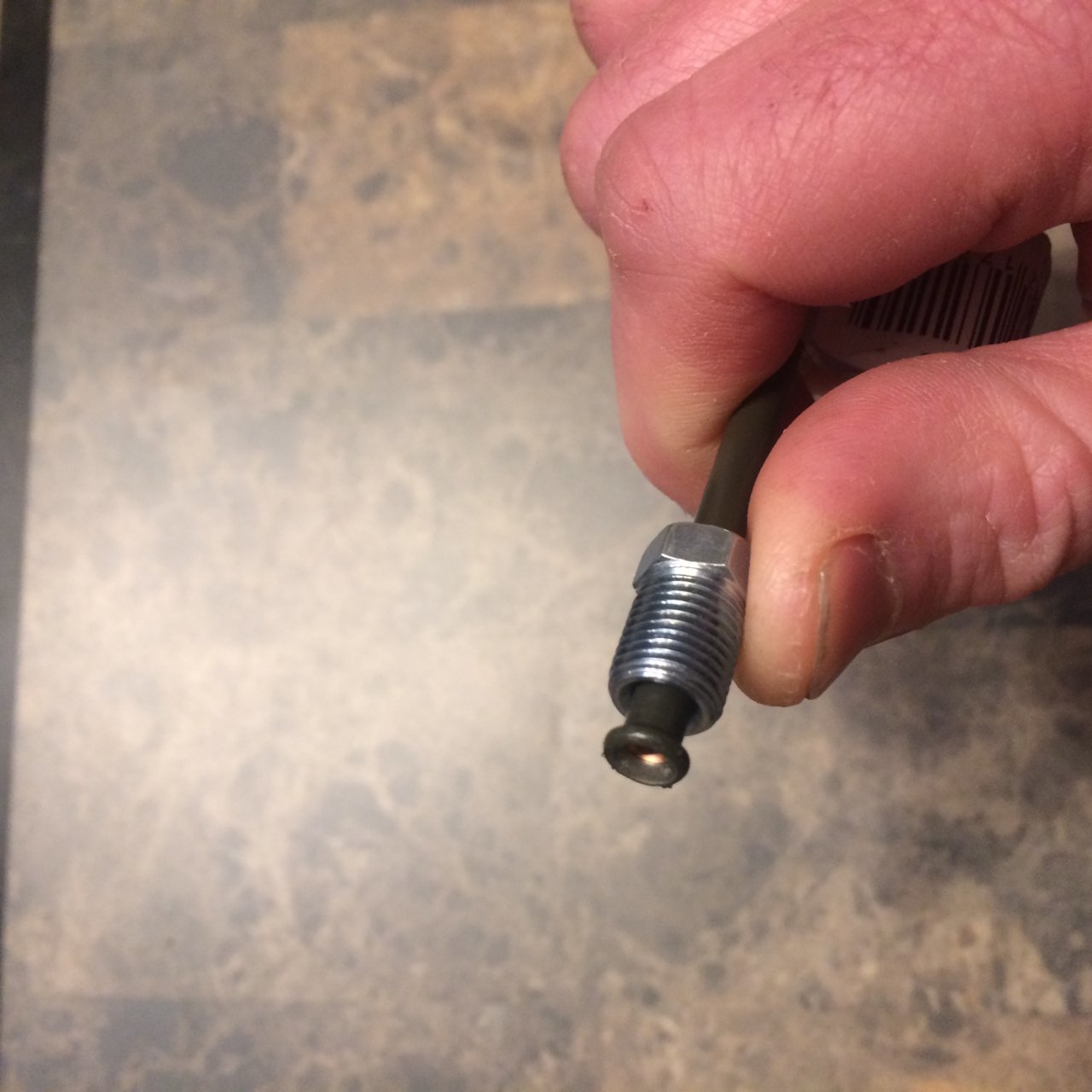

    Sooo forgive my ignorance, but I wanted to double check the stuff I picked up.
    - pre-fab 12" length of 3/16" brake line, with qty 2 M10 X 1.0 male fittings. This is what the flare looks like (double flare?):
    Here are the parts with size reference. Question - there is about 1/2" worth of threads on the male fittings. Am I going to run into problems when I hook up the slave cylinder end (ie will it seat properly)?
    Lastly, here is what one of the seats looks like inside the female union (it's convex):
    I think I'm good to go, but thought I'd post here so that people who have done this mod can correct my ass if I'm wrong.

    Looks good to me, exactly what I used.
    Yes to all your questions.
