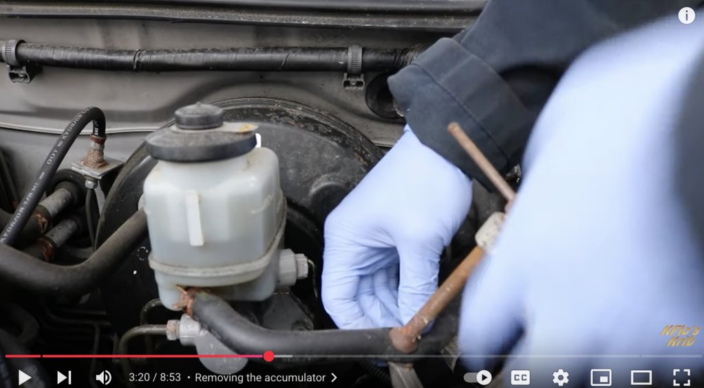

    Hey guys, I've had Firn's disk sitting in my garage, trying to get all my ducks in a row so I can do the ADM.
    For clamping the brake fluid hose, is it the one that is for the clutch or the ones for the brakes? From the Youtube video I saw the guy clamps only the big reservoir.
    Thanks in advance!
  3. May 12, 2025 at 2:16 PM
    #3583
    BLtheP
    BLtheP Constantly Tinkering Member
    Apr 5, 2022
    #394355
    4,477
    Plano, TX
    2021 MGM TRD On-Road DCSB MT
    RC60F Transmission ADD delete with FJ full-time tube FJ Metal Clutch Pedal OEM Mexico-Spec Condenser Fan 265/70R16 Michelin Defender LTX M/S 2 OEM 1-Piece Lug Nuts Custom Built Switch Panel for all Electrical Accessories Rigid Amber Pro D-SS Ditch Lights Rigid 30" SAE High Beam Driving Light Bar Rigid SR-Q Pro Back-Up Light Kit (Recessed) VLEDS Tail Conversion VLEDS Foot Well Light Kit KC HiLites Cyclone V2 Under Hood Lights Operable (Switched) Clutch Safety Bypass
    Since you have a TRD OR, yours has a remote mounted reservoir that serves the clutch directly, instead of a hose tapping the brake reservoir. Only TRD Sports have the setup you showed in the YouTube video.
    so clamp the one for the clutch. In the video you linked, he clamped the one for the clutch in that application, which is not applicable in your case.
