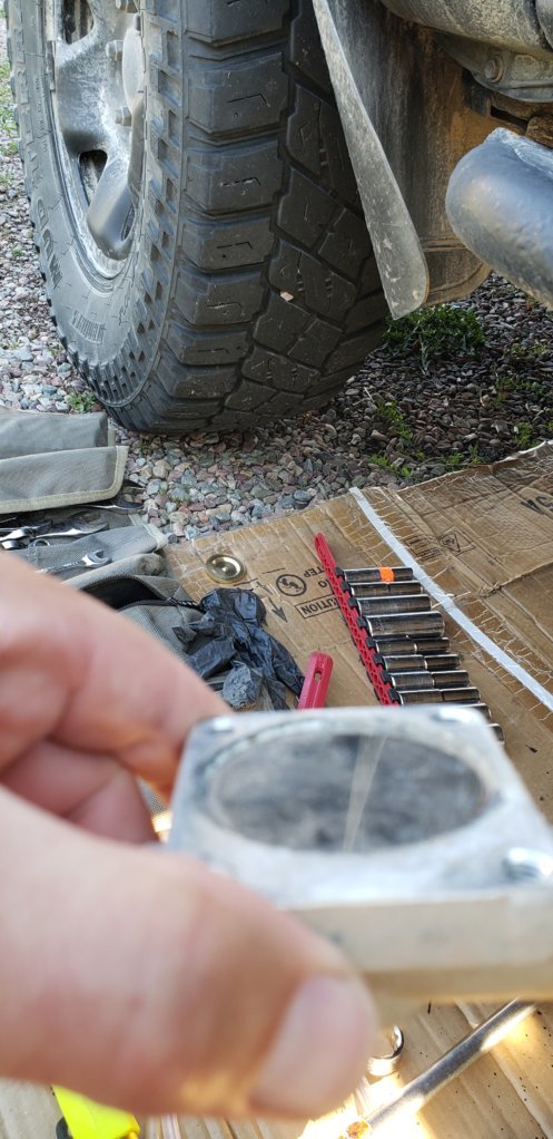

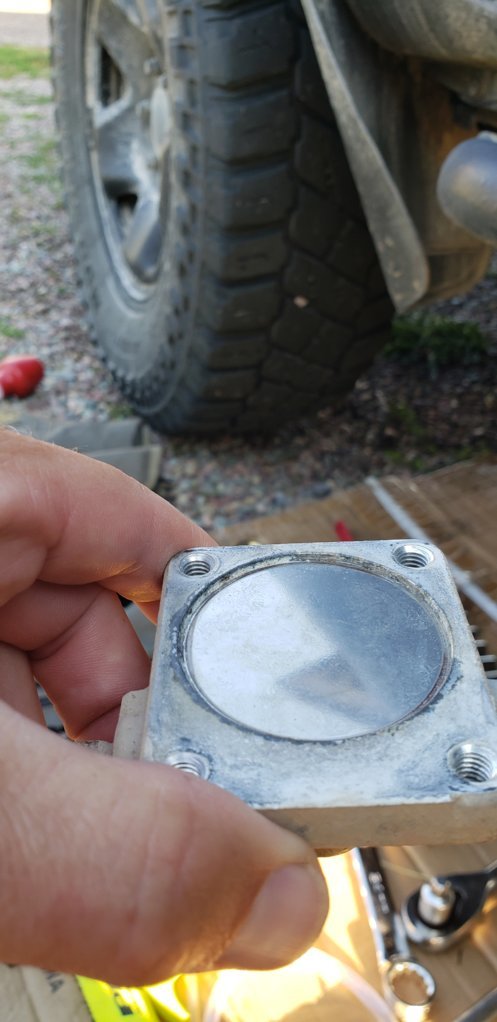

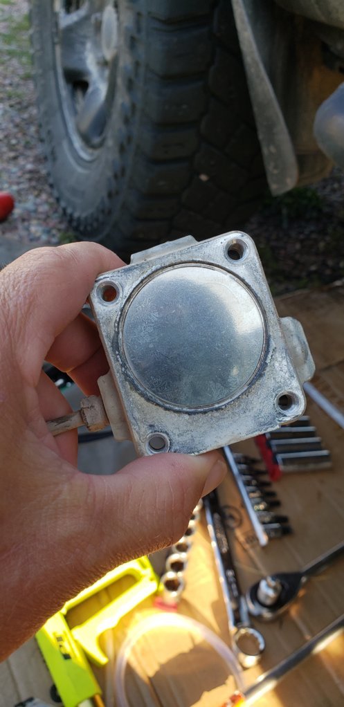

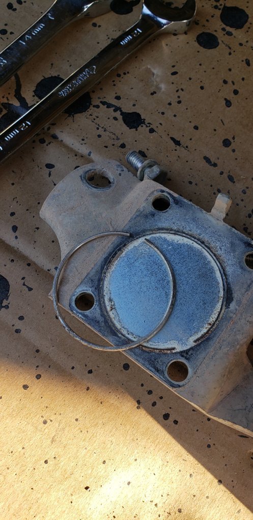

    I did this last night. Drained the lines, unhooked the accumulator, opened it up, and... wtf. No gaping hole to put the disk in!?!?20250802_185425.jpg 20250802_185419.jpg 20250802_185432.jpg 20250802_185438.jpg
    Are the '12+ models different? I hadn't read this anywhere. Surely I'm not the first '12+ owner to attempt this mod.

    You have to get the round metal plate out of there.

    I went back to the beginning and didn't read anything about removing it. The accumulator is back on the truck for now, but I'll dive in again eventually. How does the disc come out? Also, do I put it back in after installing the brass disc?
    Thank you.
    I'm sure, as with all new modification procedures, it will be easier and less frustrating the second time.

    Small pick, or suction cup, or bang it on the tabletop or something to get it to fall out. Sometimes It’s a pain. It’s in there pressed up against a rubber sealing ring. Once the steel disc comes out, you install the firm disc in its place (it now seals against the o-ring instead)
