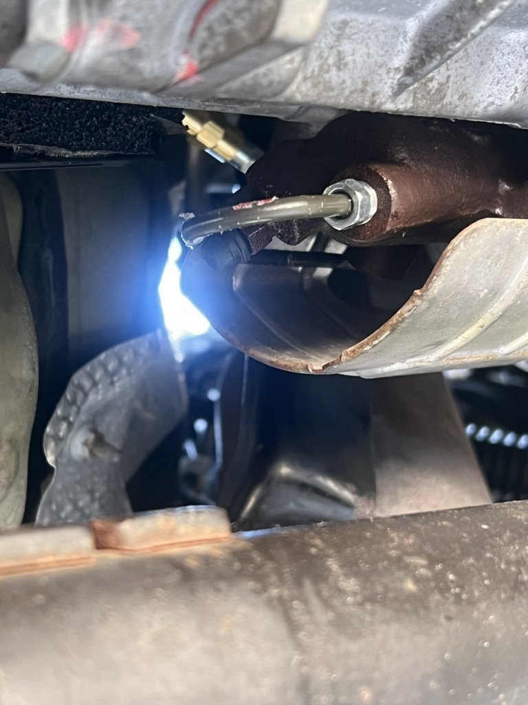

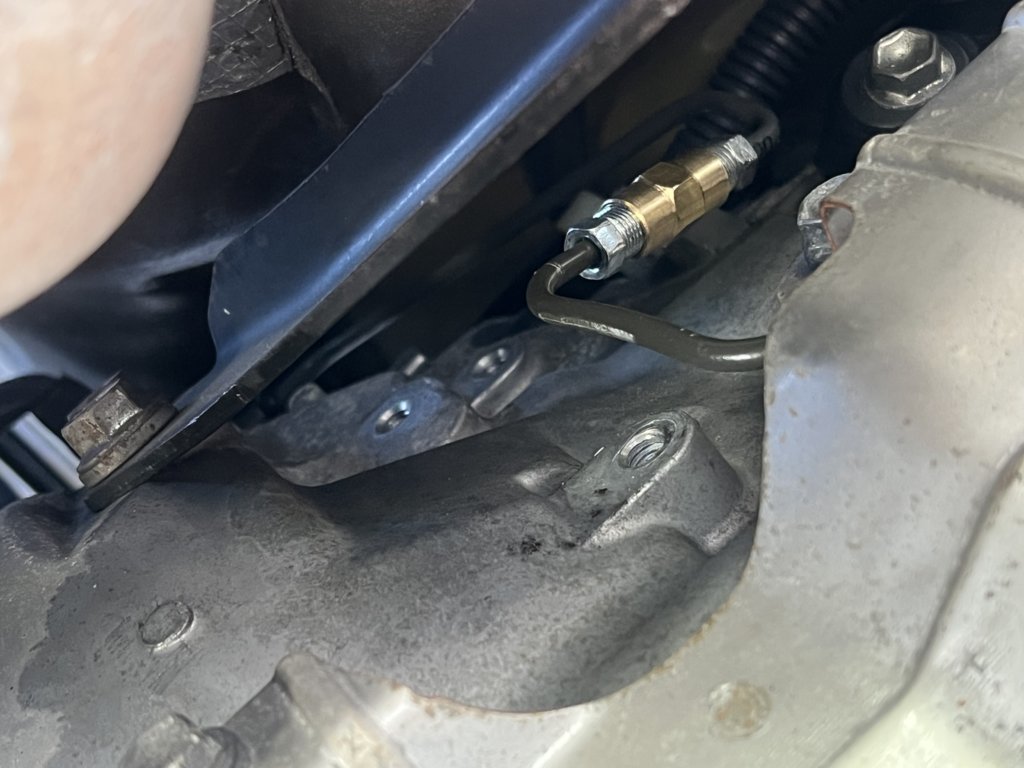

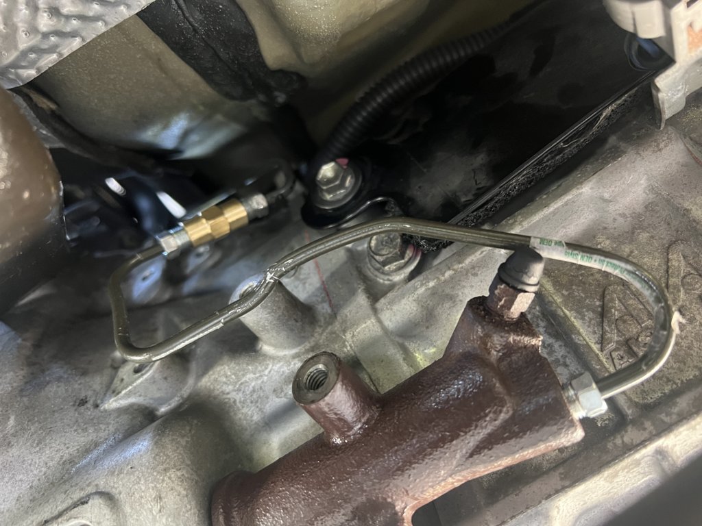

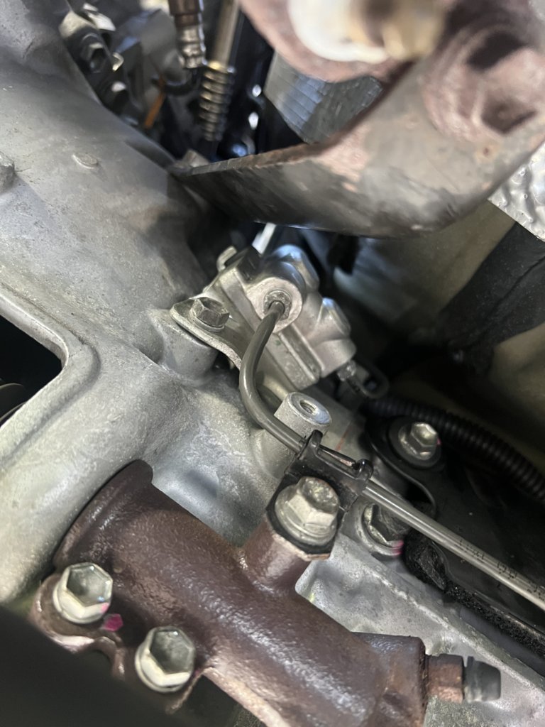

    Okay. Here’s how today went.
    Plan A: hard line. Plan B: elbow
    I forgot how little work space there is.
    Here’s the line installed. Only needed a little more convincing:

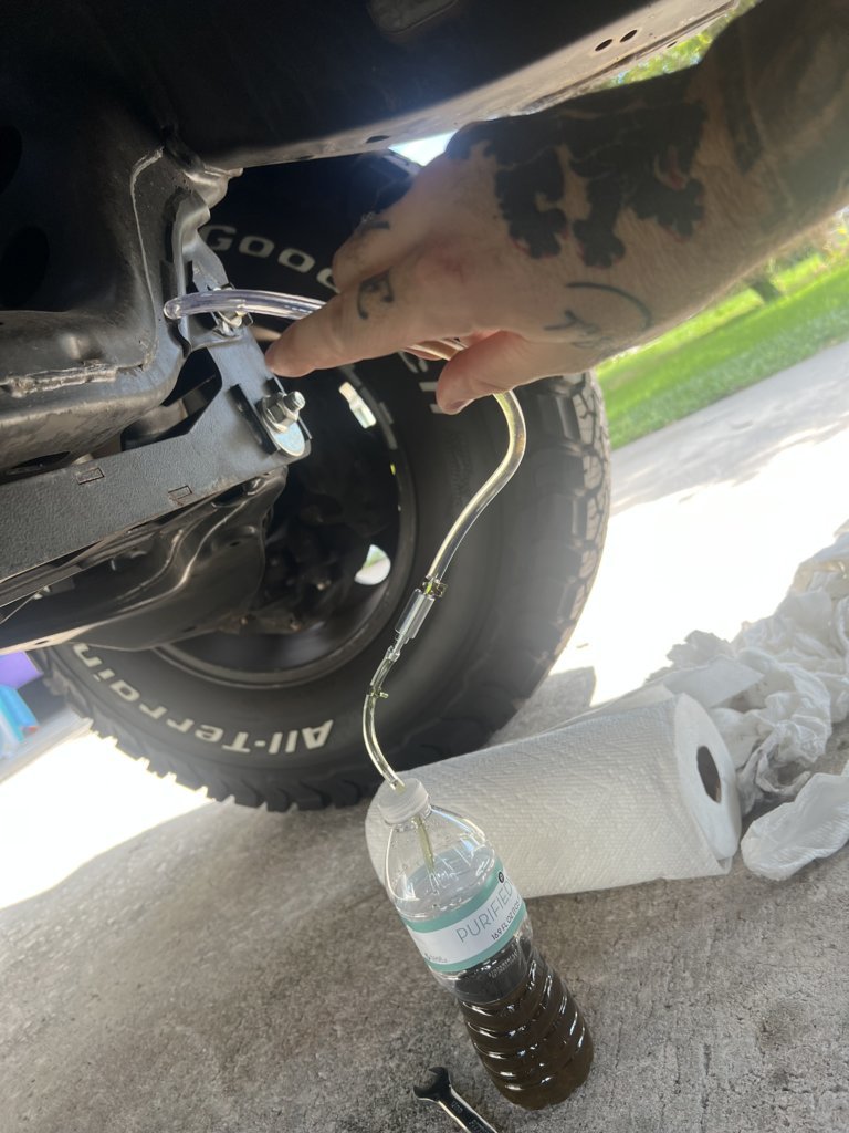

    I used this sweet one way valve bleeder I bought off TikTok. Worked surprisingly well:
    heat shield/inspection cover unintentionally fit perfectly around the line I bent:
    After laying underneath the truck, drank a beer. Sprayed it all down with brakekleen, I don’t see any leaks. Worked the clutch pedal a bunch, it feels good. No leaks so far.
    just gotta test drive it now.
    EDIT: test drive went well. It definitely an improvement over the dremel mod. I feel like the dremel mod worked like 50% of it was deleted. The hard line is a better improvement. There was a minor leak at the slave cylinder threads and I was able to get another half turn on the line nut. Another test drive, same distance, stopped in the driveway and pumped the clutch about 20 times and so far so good. No more leak.

    I haven't done the flex line. I think i still have air in the line, so I'll reserve judgemental until I can get under there again. I bought a one way bleeder and apparently it's child proof. My vacuum bleeder (hand pump) isn't very helpful either.
    Nice work!
    CygnusX191 likes this.

    Open the reservoir and gravity bleed. pump the clutch a couple times. You'll be all right

    It should push fluid out, assuming there's plenty in there.
    It's how I did mine, then close the nipple and pumped a few more times etc.
    Once you have good clutch feel, it'll work out any remaining air bubbles as you drive.
    Granted
    The tube into a bottle of fluid is still the better way
