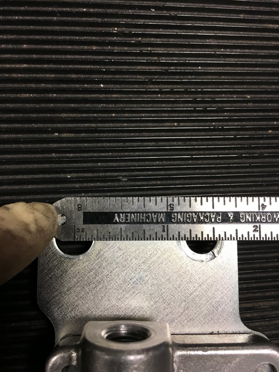

    If anyone has the accumulator mounting plate still and didn't put it back on their truck, I would greatly appreciate an approximate dimension between the top two mounting holes (center to center). A ruler by eye is good enough. A picture of the whole bracket straight on with a ruler in the shot would be excellent.

    Mine is at work. I’ll post some pics in the morning.

    ‘18 TRDOR 6MT
    Can get more if you need.

    That is perfect, thank you! What is the thickness of that bracket 3/16"-ish?

    3.75mm:)
