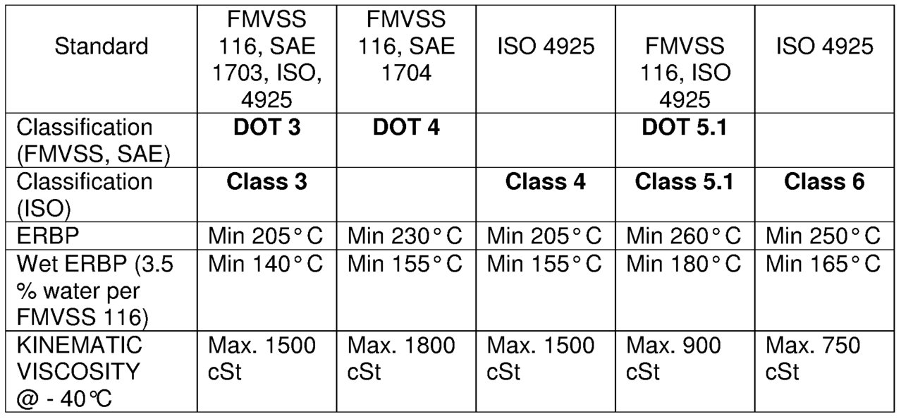

    They also have different viscosities.

    Here's a chart with temps and viscosity. Dot 4 Low Viscosity is a class 6. If you want even more involvement, lose the massively rubber damped shifter and feel more of the snick snick.
