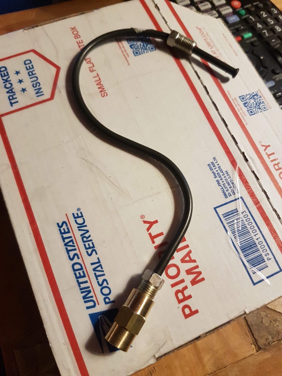

    654734ED-435A-4093-8D1D-B5A6726EAE45.jpg Got this in the mail today !!!!!
    mtip, Trident904, tonered[OP] and 3 others like this.
