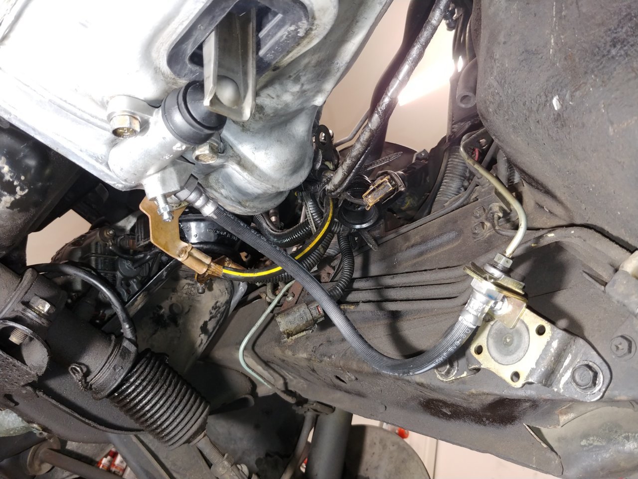

    Hi third gen folks, saw this thread and just figured I'd make a tiny chime in. I own a Nissan 300zx which also uses one of those blasted dampers. I pulled it apart and used it's body bracket to hold a brake line bracket on and ran a soft line to my slave cylinder. It's pretty common for these cars, it makes the pedal softer actually but helps with feel so you know where the engagement point is.
    tonered[OP] and doublethebass like this.

    A friend had a 3-series for a while and said they had a venturi like thing somewhere. He wanted to pull it, but sold it before he could.
    They're a menace to all MTs these days.
