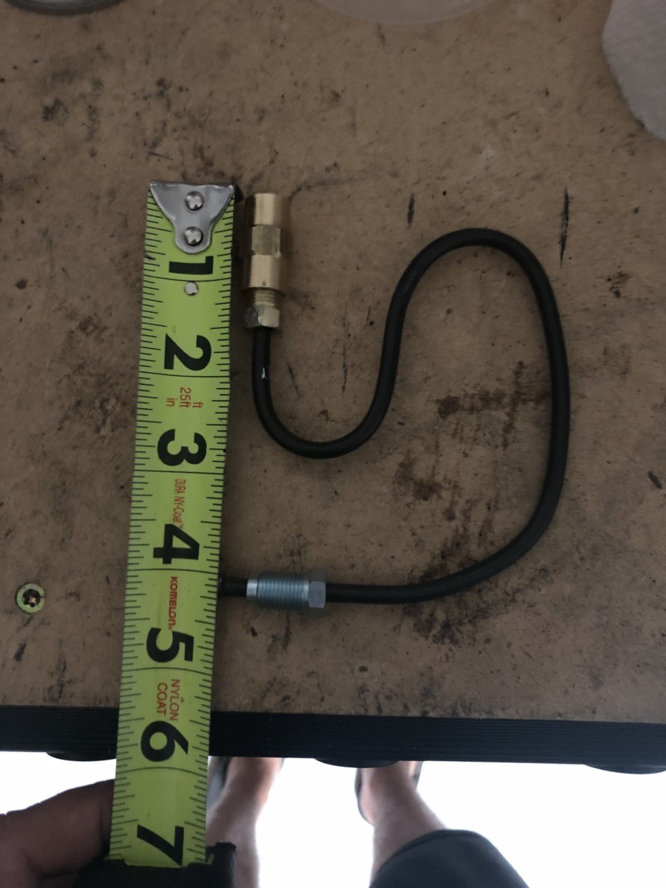

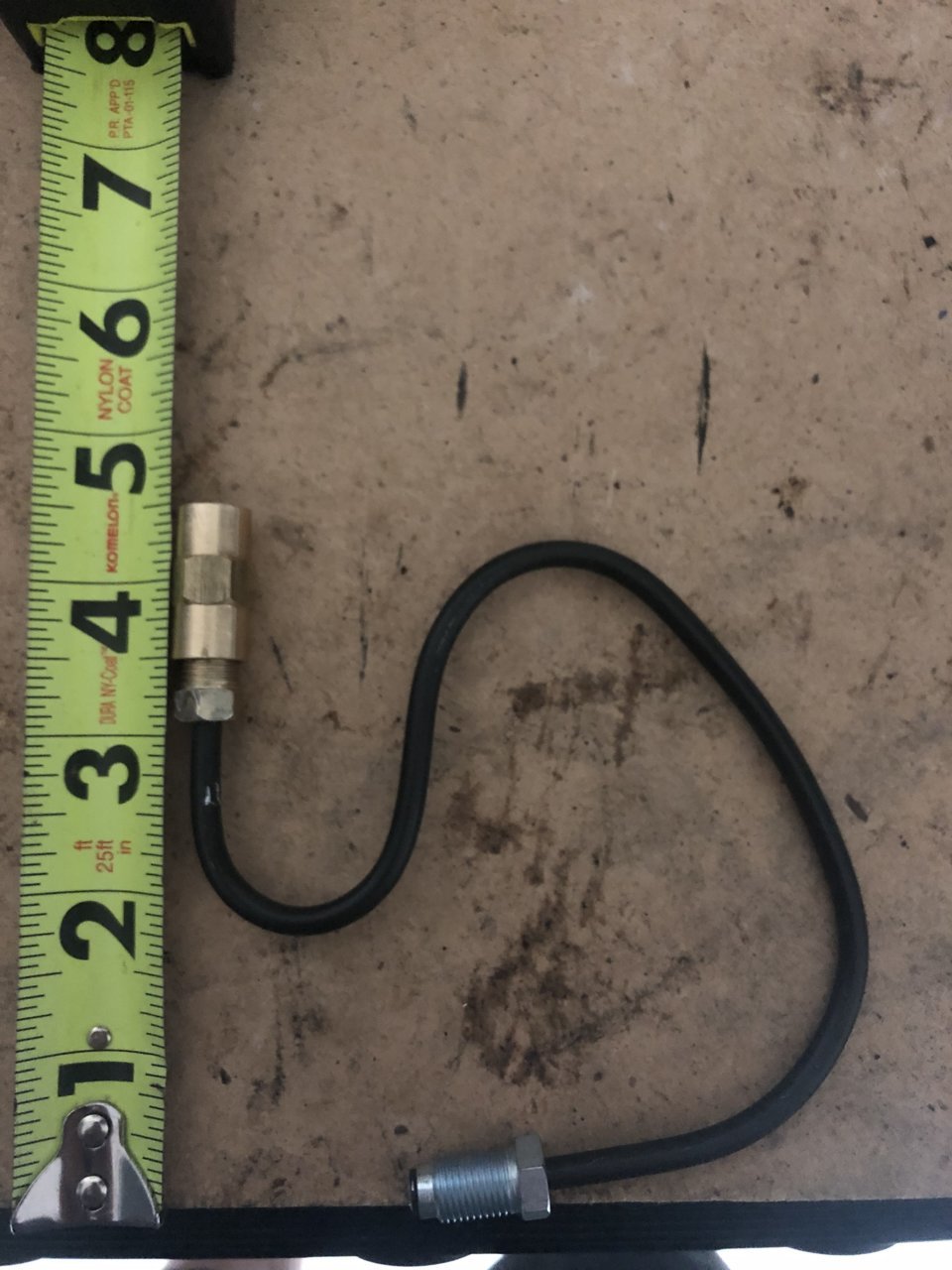

    It’s easier to just install the pre-bent line. You’re gonna have to take the accumulator off to do the dremel method anyway.

    It appears like I have one of these trucks. Mine is an early 2016 TRD sport up in Canada. The silver insulated line is not flexible whatsoever, if I connect the coupler to the that line the pre bent delete kit line sticks about 3" below the slave.

    Simple fix, straighten the U bend by hand and rebend around a 20mm socket to fit.

    Does that extra bend I will have in the line make it more likely for me to get air trapped in the line while trying to bleed it?

    No, not at all. When you bleed it, you’ll force the air out.
