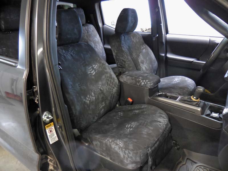

    On another note, can we talk about your towel seat covers? I did that for a while when I had my '14, then I found a headwaters seat covers.
    Paul, the owner was originally personally measures and creates the templates for each vehicle and they fit like a glove. The install can be a bit tedious because the covers fit so tightly, but the result is worth it. The material is Cordura with a waterproof backing. They are extremely durable and are not slippery. A set for the front buckets including the console cover will set you back $240, but you won't be disappointed. He also offers some nice options for pouches, map pockets, and scabbard etc.... I have the hanging knee pouch which is really nice to toss your wallet and phone into instead of having it in front of the shifter.
    https://headwatersseatcovers.com/product/2016-2019-tacoma-buckets/
    This is not my truck, but it is a photo Paul sent me when I inquired about new covers for my '17. I have these exact same covers in my truck now.
