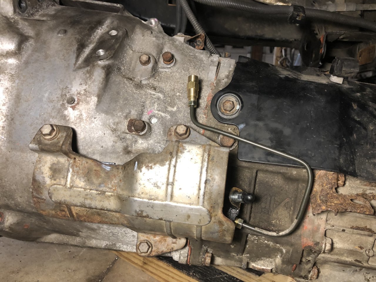

    Replaced engine with an '07 FJ Cruiser motor. Clutch accumulator deleted. WIP. plan to add new exhaust, cold air intake, URD short throw shifter,
    Just found this thread. broke the hydraulic line between the accumulator and the slave cyl for my MT trans when trying to get the flare nut off when pulling the tranny.
    bought a new one from the local yota dealer, but when I got it home this weekend it didn't fit. bends weren't correct. but length was almost perfect and had the right flare fittings on it.
    So I bent it and made it work haha. had to bend the cover plate to accommodate it now though. nbd.
    hoping there's no restriction in the line now though.
    now i'm wondering if I shouldn't just delete the whole accumulator while I have the tranny out...
    is it a big improvement?

    When look for options to do this mod, I found that there were a few different line setups.
    No matter what, yes. Delete the accumulator. I got my starting info from you 2nd Gen folks.

    Good deal, thx! I was gonna say, this looks exactly the same as my 2nd gen.
    Will do! Prolly use the flex line.
    Cheers

    If you already have the hard line from Toyota, you may be able to grab a coupler and put it in line to replace the accumulator. You'll probably need to open up the bends a little on both the upper and lower tubes, to get them to line up and join the coupler.

    Decided it would probably be better to summon you from the correct thread but is there any disadvantage to doing it the dremel way instead of the hard line way? I have very little mechanic type experience. I change my own oil, that’s about it. And the hard line way seems a little bit outta my league although I’m always down to try.
    Most of the replies in this thread are over my head! Lol

    No disadvantage that I can tell,it really is quite simple The only hard part is getting your hands and tools in where they are needed.

    you need the same hand tools to do either method. The Dremel method will be "invisible" to anyone who is under the vehicle. Just make sure you clean it out well before you re-install.

    Busted this out today. Thanks for the part numbers & tips. $10 at autozone and 20 min under the truck and I’m accumulator free! 95B0462C-0B30-46FD-BBD5-222BBEDF22F5.jpg

    Nice mod. That was a long time coming!
