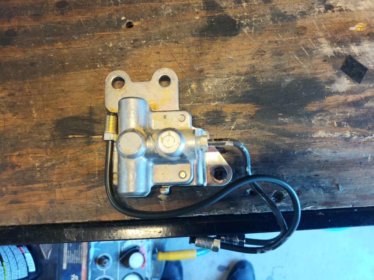

    Finally got around to doing mine today. I bought the flexible line darkyota33 showed on here from paragon performance, it worked but the two 90 degree fittings isn't needed, just the female end needs to be a 90 and the male end can be a straight fitting. With the two 90's on the line, it puts it in a weird S shape and it covers the rear most hole for the cover as shown in the first photo below. The second photo shows how it would be if it had a straight male fitting.
    I didnt like how the flexible hose fitted but it was 100% functional, and definitely needs to be held down cause it is pretty floppy just dangling there. I ended up bending some hard line and using the male to male adapter using the accumulator as a guide on the bench.
    If anyone wants to use this hose instead of hard line, I paid $33 shipped to my house, Ill ship it to you for $20.
    I also bought two hard lines in case I messed up, I didnt and ended up bending the other line for no reason. Its reasonably lined up but some fitting is required. PM me if you want it for free, just come pick it up in SoCal or pay the shipping ~$5.

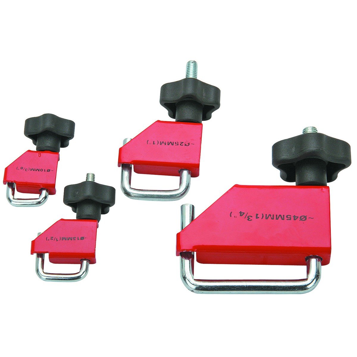

    I grabbed these to pinch off the line to the master cylinder and they worked well. image_16750.jpg
    Bleeding was simple. I put a hose on the bleeder, topped off the reservoir, removed the clamp, and opened up the bleeder. I let it drip for 5-10 min and then closed it off. I employed the help of my better half to make sure it was completely free of air. I had her 1/2 press the clutch while I cracked the bleeder and closed it. We did have to pull the pedal up off the floor and did this 5-10 times. It was probably good after 2, but I had overfilled the reservoir and needed to remove some fluid anyway.

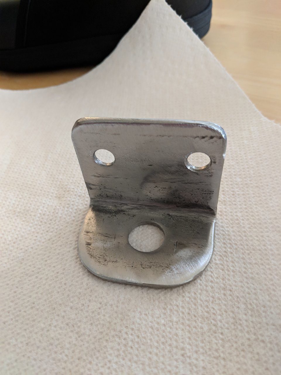

    Here is a picture of the crappy bracket I made out of 2" angle iron with a drill press and an angle grinder. I painted it with truck bed liner yesterday before installing. For those of you paying attention, yes the hole on the right is off.... Luckily I realized it before I painted it. I didn't measure twice before cutting. :frusty: When I get the new hose installed I'll post the updated drawing along with a few pictures if I can get better ones than I did today.
