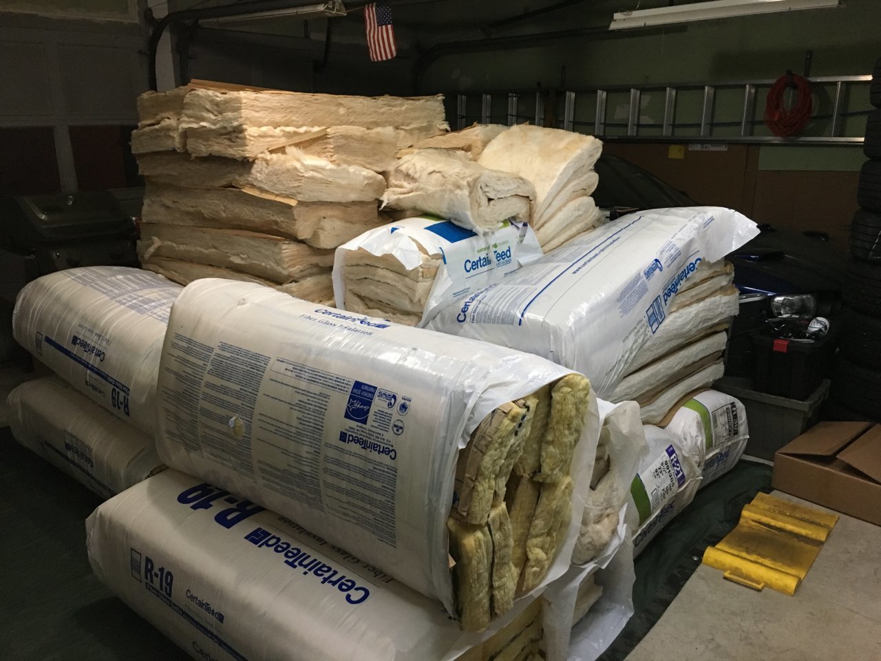

    Mine is full of insulation to go into my attic.

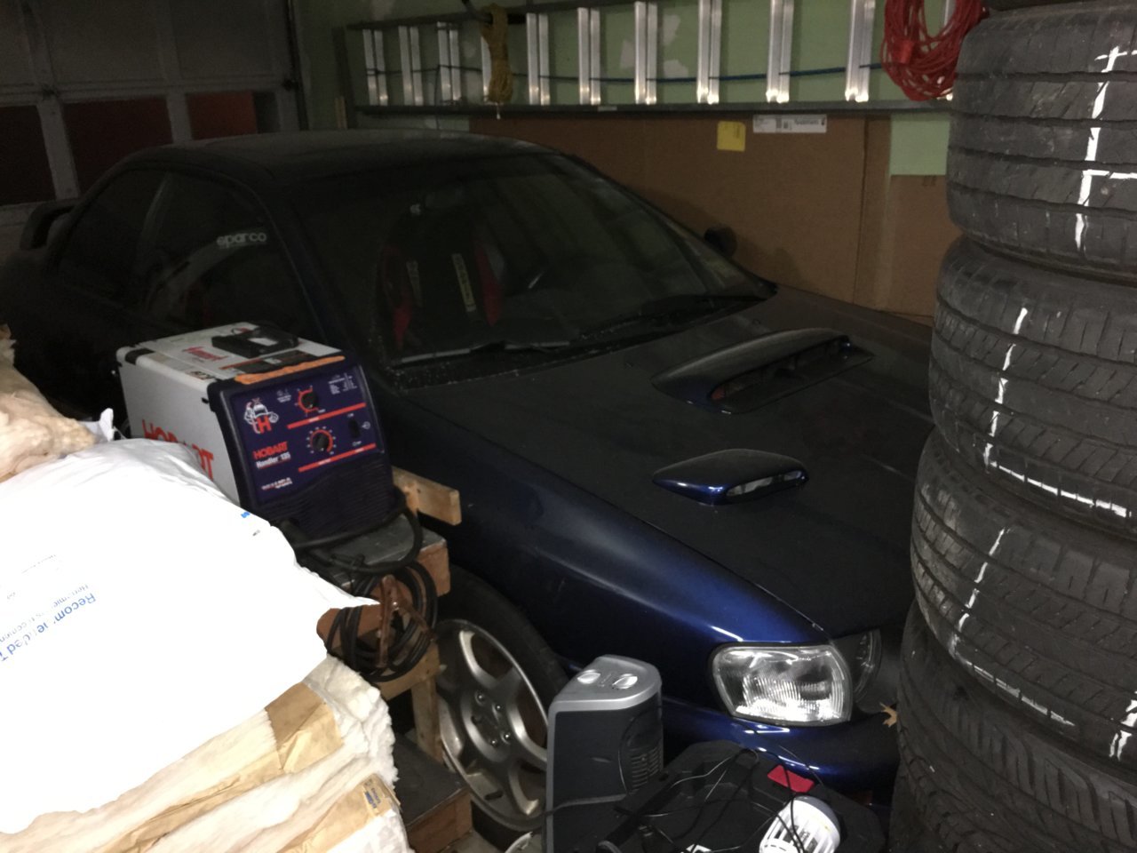

    My little girl is buried. :(
