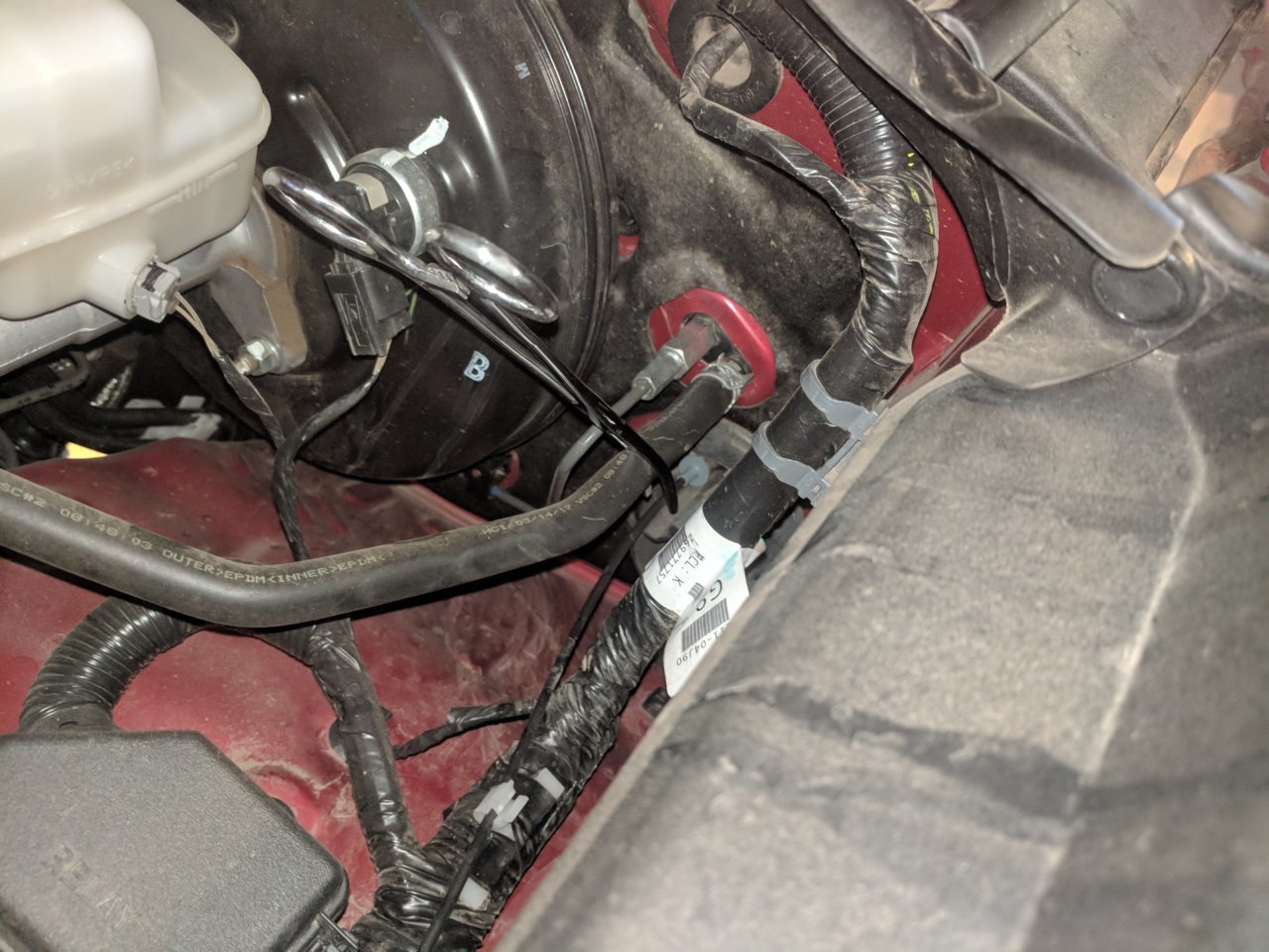

    hey quick question, what did you use to pinch the line under the hood so it doesn't let air in or fluid out?

    I used these:

    The 1/2” harbor freight clamp
