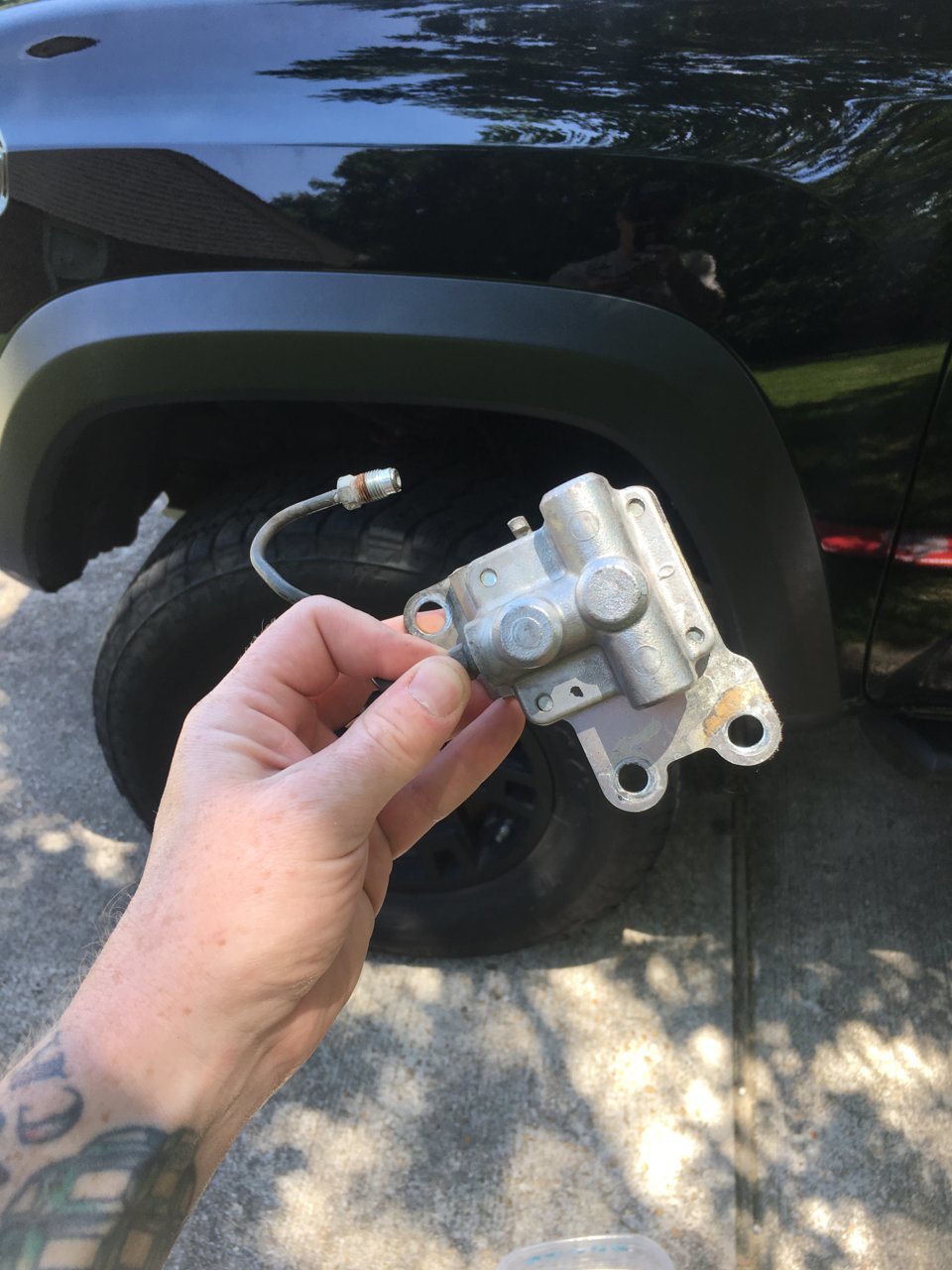

    Took me about twice as long as it should have, thanks to the upper-most flare nut, but I removed my accumulator today.
    I echo what others have said about the clutch finally feeling like it should have from the factory. Thanks to @tonered for this thread, and @Trident904 for the kit he developed to simplify the upgrade!
