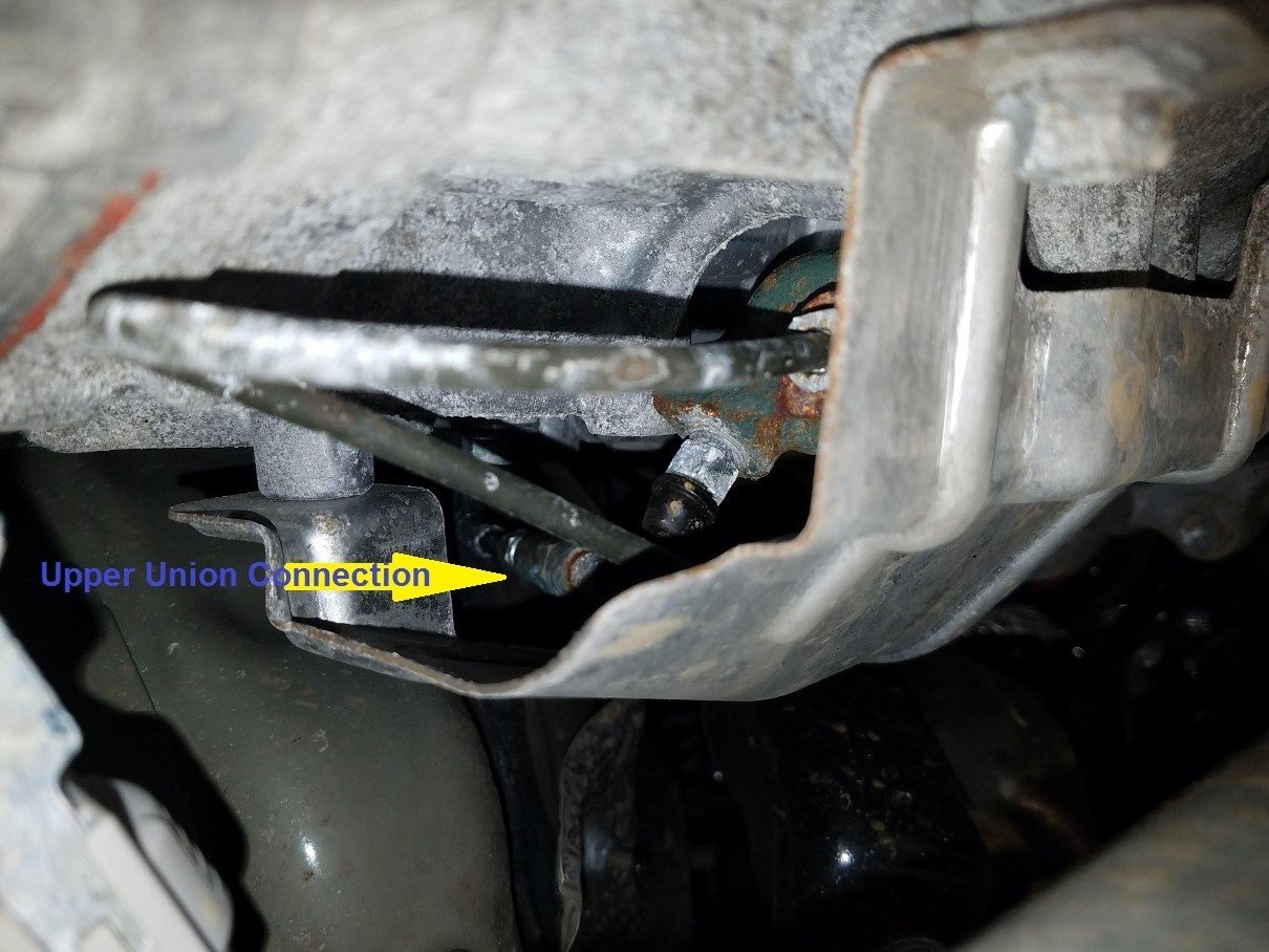

    Do we happen to have measurements between the bends? It would be nice to just head over to the local auto parts store and have them pre bend a brake line up for me.
  16. Jul 1, 2019 at 4:38 PM
    #1096
    fatboyfirebass
    fatboyfirebass Well-Known Member
    Mar 24, 2018
    #248258
    1,063
    2018 Blk TRD OR DCSB MT6 Prem/Tech Pkgs
    OV Tuned, S&B Intake, MBRP Dual black Cat-back, accumulator delete, URD SS, 2LM, SSO Hybrid bumper/Warn 10kSynthetic, Custom Car Grille, MESO Ultimate Turn Signal in KTJO Power Folding Mirrors, Genesis Dual Battery, BHLM with LED upgrade, Fog delete, Geko Bed & Underhood lighting, Rear camera anytime, Nav Block Override, 400W anytime w/ interior outlets, USB charging stations, DE-badged, TVD blackout kit, HiLux interior door handles, Hybrid SS/Delrin Shift Knob, Cali-Raised bed Stiffeners, Ultimate Tailgate Seal, "El Dorado" Dual-quad horns, Diamondback HD cover, Mobtown engine/trans skid plates, RCI control arm skids, JLT oil catch can, Meso overhead Hex rack.
    Sorry, I didn't measure mine when I did it. I am still kicking myself over not getting a pattern to share with the group.
    But, it is pretty easy to bend by hand if you are careful. If you don't have a tube bender, use dowel, or hammer handle or piece of PVC pip as a mold. The upper connection kind of wants to lean in to ward the center of the vehicle to line up right. So flex it in by hand, to get a good alignment as you install.
    Be sure to get the Armour brand brake line. It has fittings that are long enough to engage the stock Toyota fittings. I found it at O'reilly's
    A good method of finding the close bend pattern would be to get an old wire hanger, or maybe a piece of welding wire, the same length as the brake line. Go under the vehicle and get your approximate bend pattern.
    Then come back out and bend the brake line on the work bench, or take the pattern to the parts store and have them bend the line for you. See the first post for part numbers and pictures of fitment.
    Also, if you do get a good approximate pattern, please share it here for others who may want to work up their own kits.

  17. Jul 1, 2019 at 4:44 PM
    #1097
    sherwoods_Fleet
    sherwoods_Fleet Well-Known Member
    Jun 29, 2019
    #297783
    243
    2019 Cement manual Tacoma+
    Procharger 5.29 Nitro Gears 6 inch RC lift 35x12.50r17 17x9 -38 offset, 3.5 backspacing SCS Ray10s Gunmetal gray. OEM Audioplus sound system Accumulator Delete
    Perfect, the wire hanger is a really great idea! I’m getting 5.29s put in next Monday so hopefully next weekend I will do this mod and get exact measurements for the group. Or maybe a DIY video.
    tonered[OP] likes this.

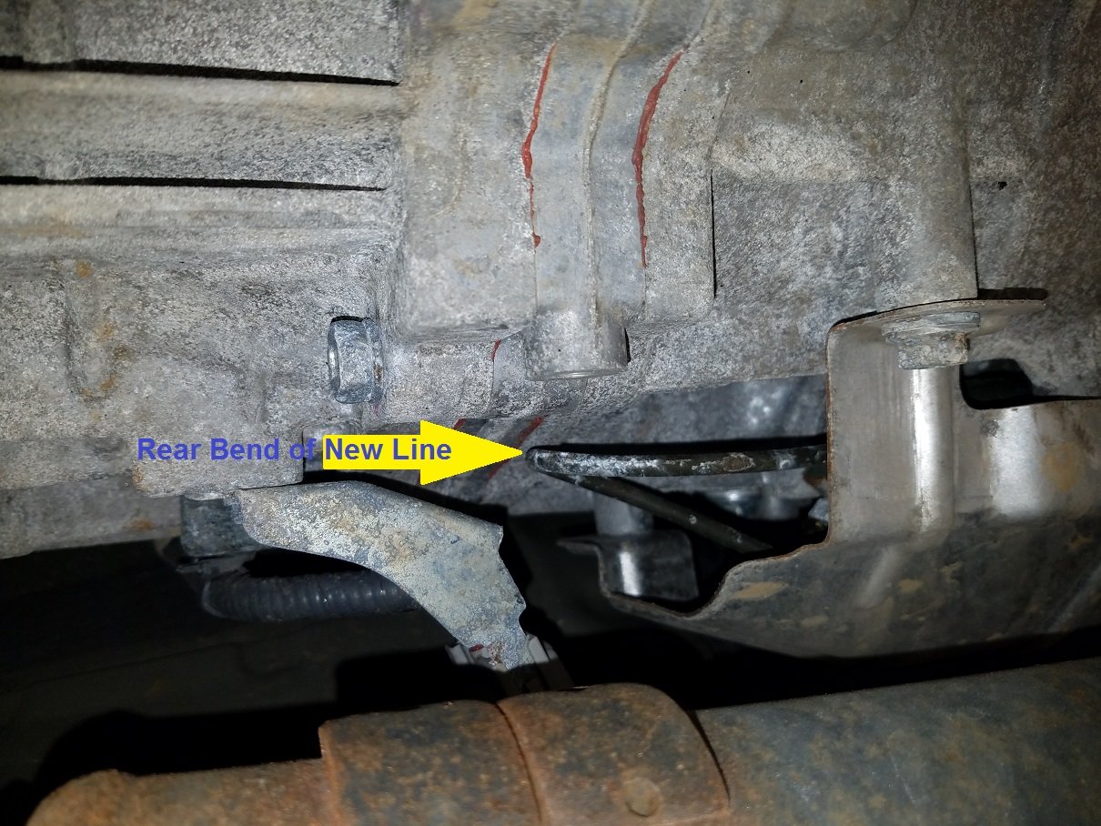

  18. Jul 1, 2019 at 5:04 PM
    #1098
    fatboyfirebass
    Mar 24, 2018
    #248258
    1,063
    One thing to note, If you put the cover back onto the transmission, the rear bend will extend a little bit beyond the shield toward the rear of the vehicle.
    I just snapped a couple of quick shots looking up from the ground
