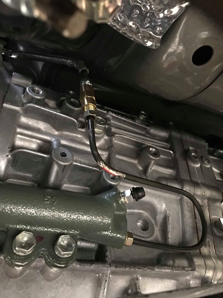

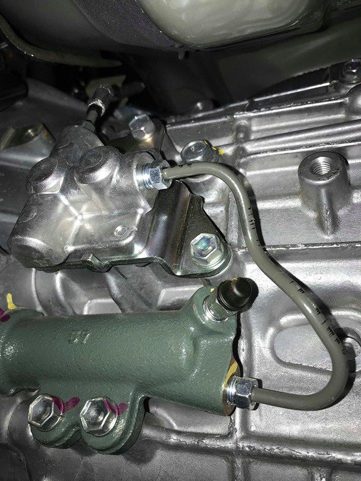

    Finally got mine done. A bit of a PITA but got it done. Did a quick drive and so far feels nice.

    The hardest part was getting the lower fitting threaded. The line felt a bit too long so it took some time to move it around, carefully, so I could get the fitting threaded.
    I have heard getting the shield back on can be tricky as well since the hard line is bigger, as it were, and can cause some slight fitment issues.
    I'm keeping mine off for a day to make sure all is well.

    If you happen to contact the shield, you can gently massage the line if that helps and bend / form the shield at will.

    When I did mine, I started the threads on the bottom into the slave, then connected the top line and tightened, the pushed the line into the slave and tightened. It worked pretty well and I’ve had no leaks in mine

    Ya, I got here on. Took a bit, but I got it. So far no leaks it appears. I am keeping the shield off till tomorrow so I can keep an eye on it. So far, it feel much better.

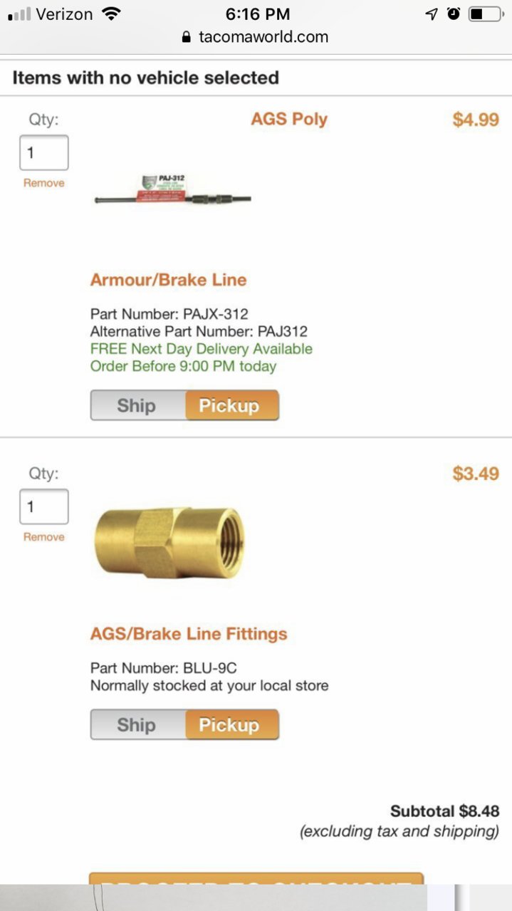

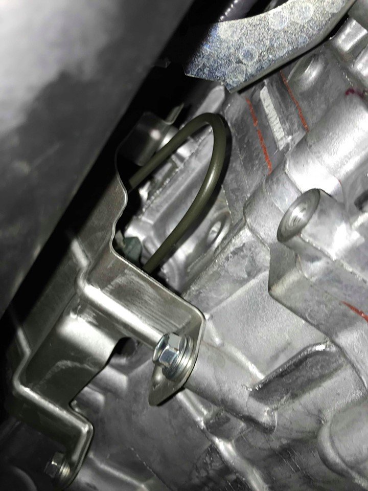

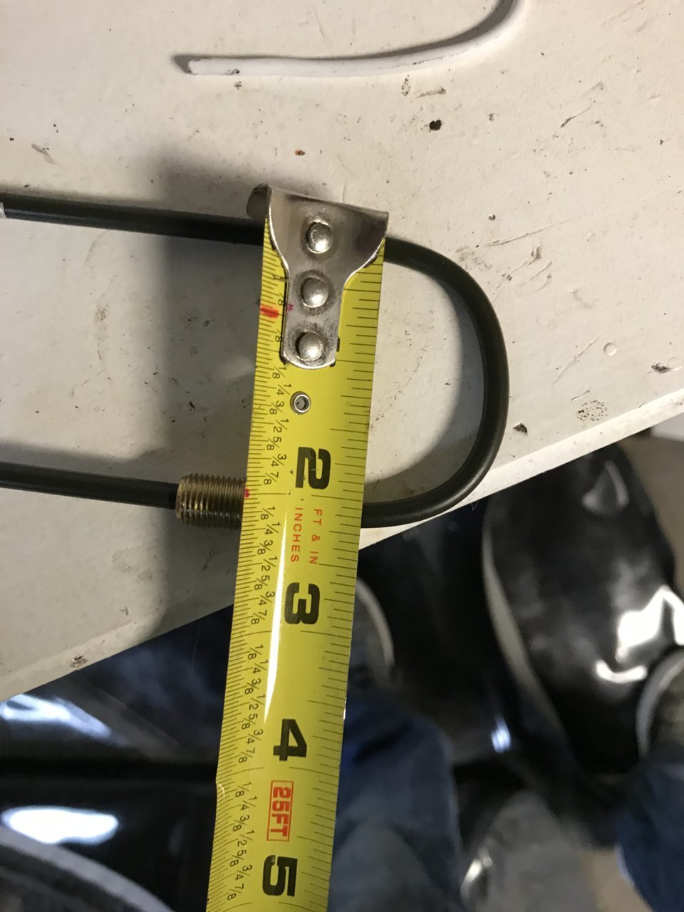

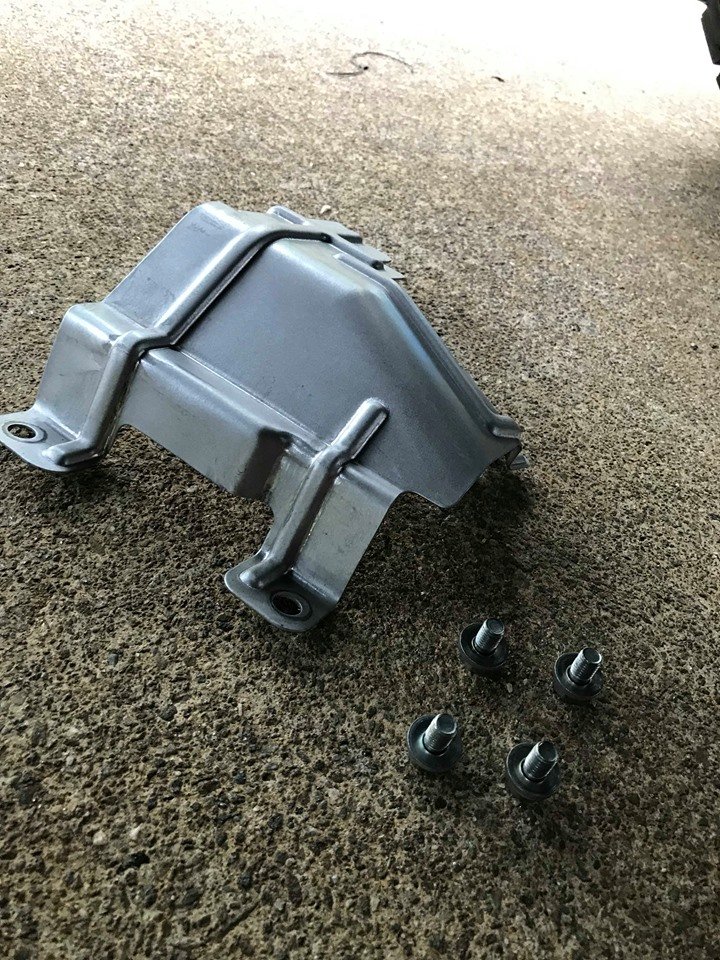

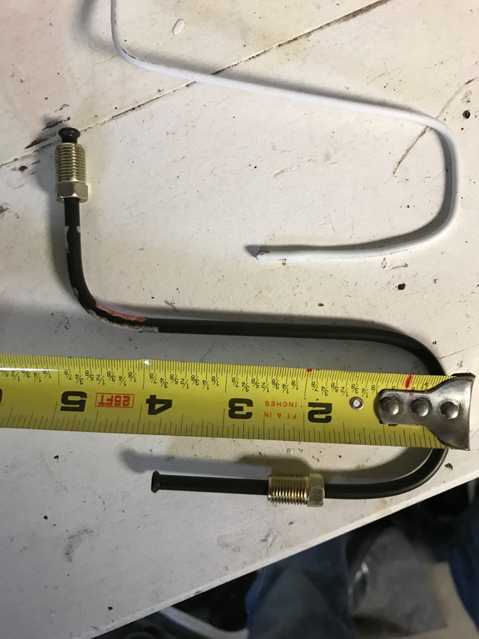

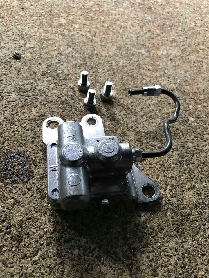

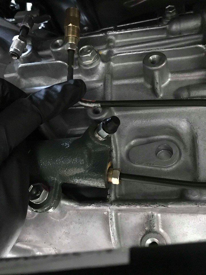

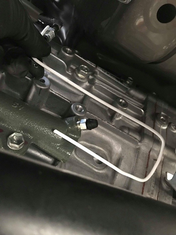

    okay 9$ and one beer and got this puppy pumped out. got my 5.29 gears in earlier this week and with the increased RPM, higher low end torque from the gears I noticed that the accumulator is causing my shifting to lunge and really take away from my acceleration if I want to pop the clutch a little faster then normal, so I decided its time to try this out! it feels AWESOME! the clutch feels wonderful, I know EXACTLY when the clutch is going to smack that flywheel and best part it slaps the flywheel and stays ON it!:headbang: It doesn't bounce off of the flywheel because of the accumulator pressure regulation anymore and doesn't make the truck lunge 2 to 3 times:bikewhoops:. Also downshifting is great. you can really tell that this mod allows SMOOTH shifting. absolute must haves on these trucks are 4.88, 5.29 gears and an accumulator delete feels like a totally different truck my friends! for those DIY guys here's a little write up of what I did.
    Go hit your local autozone and pick up these parts.
    1. Clamp this hose

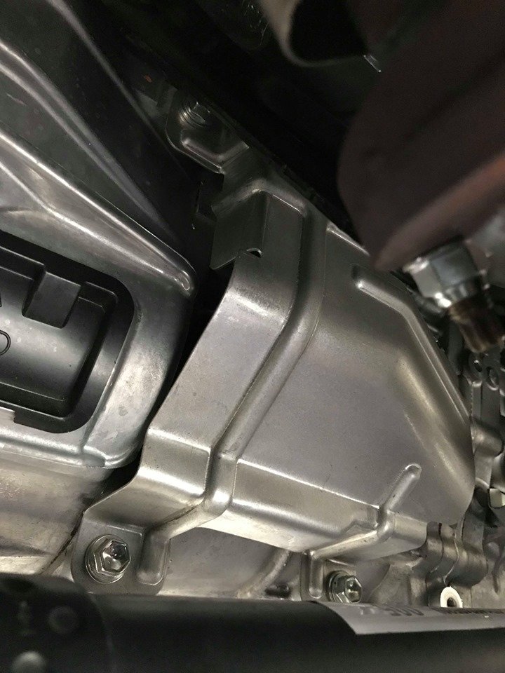

    2. Remove 4, 12mm bolts holding the heatshield to the transmission protecting the slave cylinder.
    3. Personally I went ahead and loosened all the bolts and clutch lines to be able to take everything out by hand. use a 12 MM to loosen the 3 bolts holding on the actuator. then use a 10mm to loosen the fitting connected to the slave cylinder then loosen the fitting on top of the actuator coming down from the firewall. next remove the 3 bolts to separate the actuator from the transmission. finish by removing the fitting going into the slave cylinder and the fitting screwed into the top of the actuator.

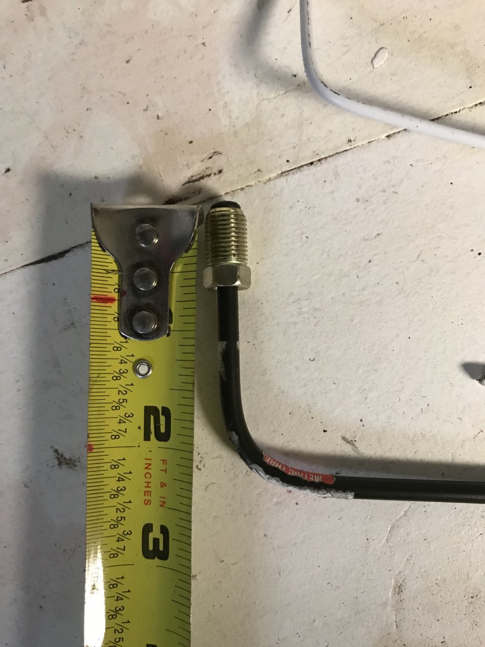

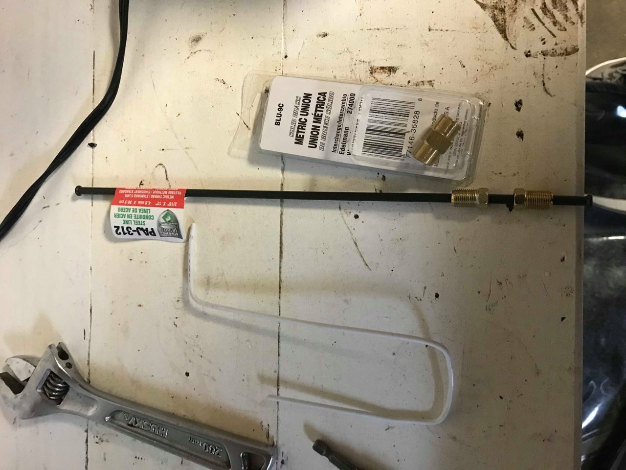

    4. Optional: get a wire hanger and make your bends. I forgot to factor in the new coupling so I was a bit short as you can see im a bit to far to the right of the fitting coming down from the firewall. but I just pulled the line from the firewall to the right until I was able to screw it in. so as you can see you can mess up your bend and still make it work just fine! I bent the line using both thumbs just do your best to go slow with bending and try not to have to straighten it back up or bend the opposite way after a bend because you will kink the line.
    5. Use a 10MM for the clutch line fittings and a 15MM for the coupling and tighten your new line in.

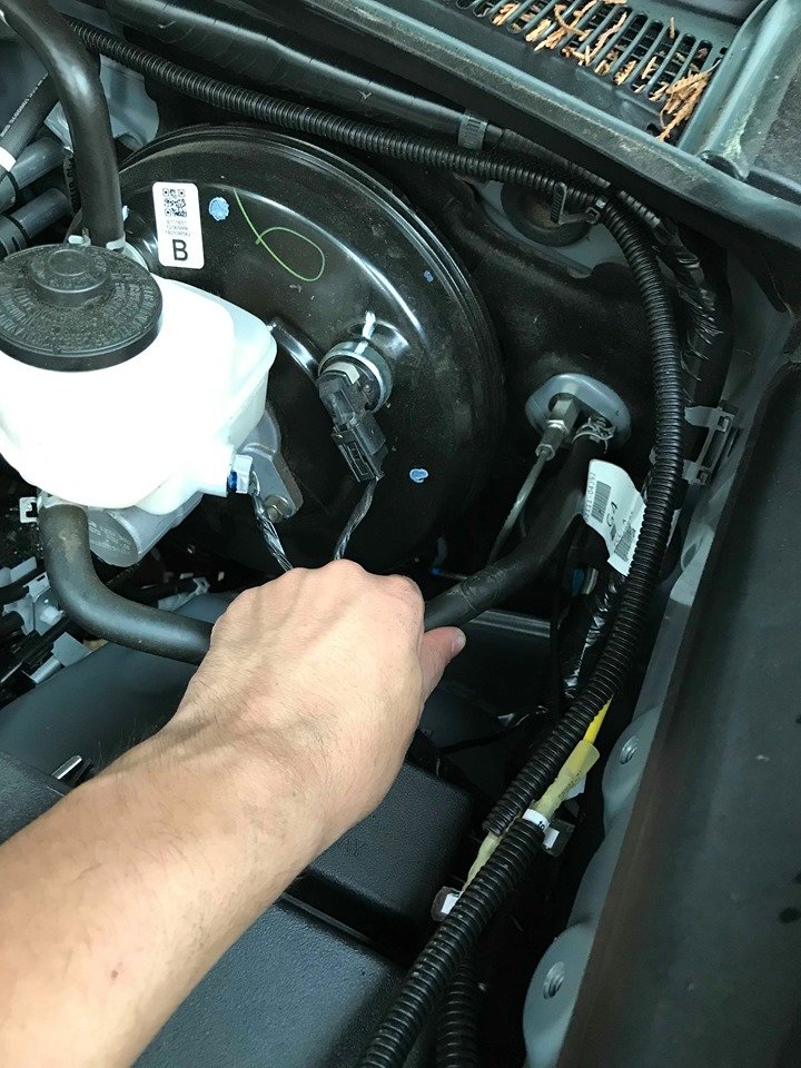

    6. Loosen the bleeder on the slave cylinder, then once loose go into the engine bay and remove your clamp from step 1. by the time you get back under the truck it should be dripping pretty good and you can tighten the bleeder screw.
    7. re-install the heat shield using the 4, 12MM bolts.
    I hope this helps someone! let me know feedback on how you like the new feel. I absolutely love it.
    Even though I was off and not perfect with my bends if you wanted my measurements that I used here they are. (the first picture is the one that should be shorter maybe 1/2" to 3/4" shorter and that length added into the second picture top side of tape measure length.)
    CE196360-DBDA-4423-9731-D964B2E262DF.jpg 30D6B09D-DB5E-4935-8CD5-B2F1D0343AB8.jpg 721C2757-11CC-4002-A03A-7BEEEB32F1FF.jpg

    I still have no idea how you guys are getting such good pictures under there. I always seem to be either too close to what I'm trying to take a picture of, or have it completely out of frame!
    Thanks for the writeup, and I vote for turning this into a .PDF and putting it in the first post. I will volunteer to make the PDF.
    I agree though, this totally eliminates that excessive clutch slip during "spirited" driving.
