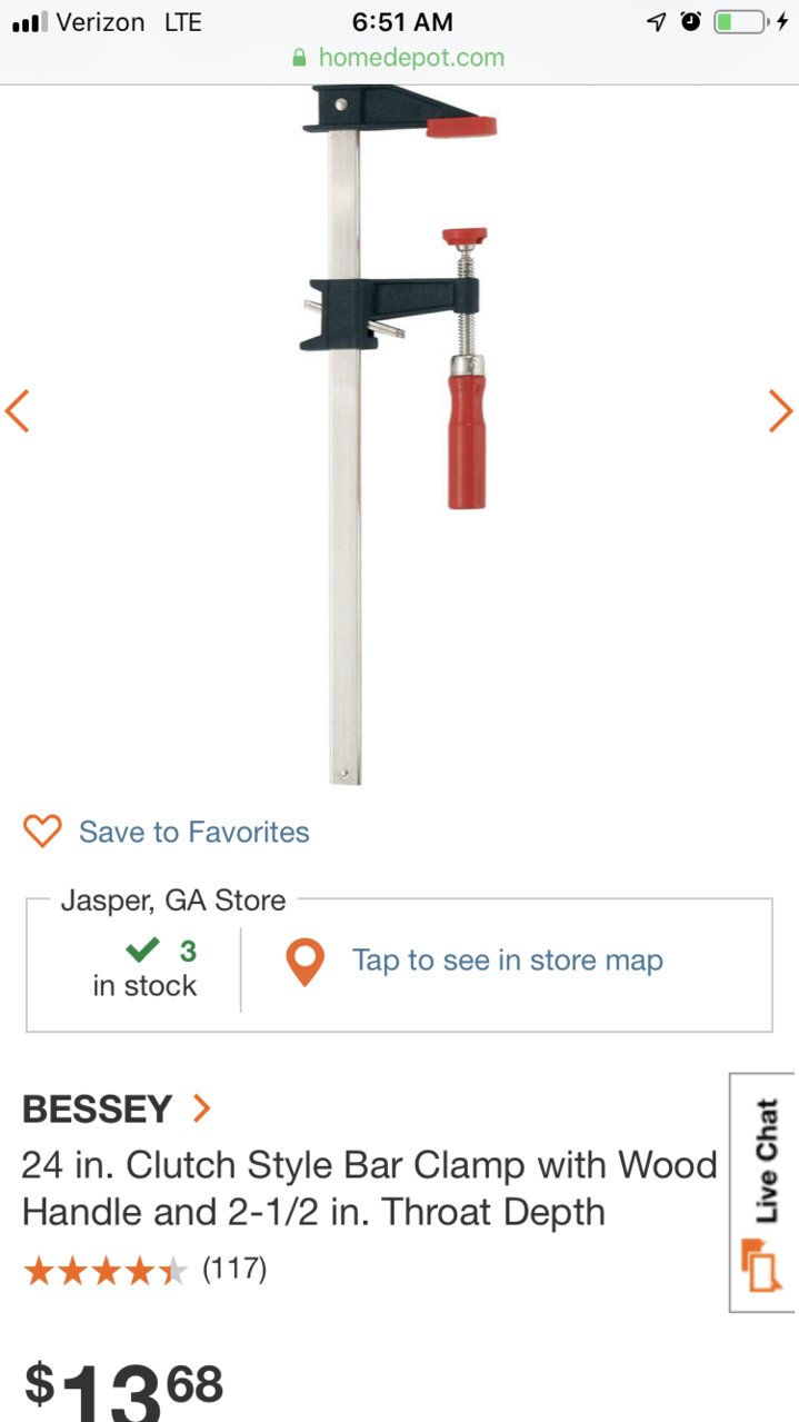

    Awesome!! What did you do for pinching off the line? Vise grips?
    I picked up the parts today. Just gotta wait till work since H.O.A. are a bunch of d-bags and dont allow working on vehicles.
    tonered[OP] and mcharfauros like this.
  20. Jul 20, 2019 at 3:52 AM
    #1140
    sherwoods_Fleet
    sherwoods_Fleet Well-Known Member
    Jun 29, 2019
    #297783
    243
    2019 Cement manual Tacoma+
    Procharger 5.29 Nitro Gears 6 inch RC lift 35x12.50r17 17x9 -38 offset, 3.5 backspacing SCS Ray10s Gunmetal gray. OEM Audioplus sound system Accumulator Delete
    I couldn’t find vice grips, best thing I could find was some kind of clamp from homedepot I had lol. If you use vice grips try to have something soft like a small rag wrapped around the hose just to help prevent any of the teeth on the grips from puncturing the hose if you happen to clamp it to hard.
