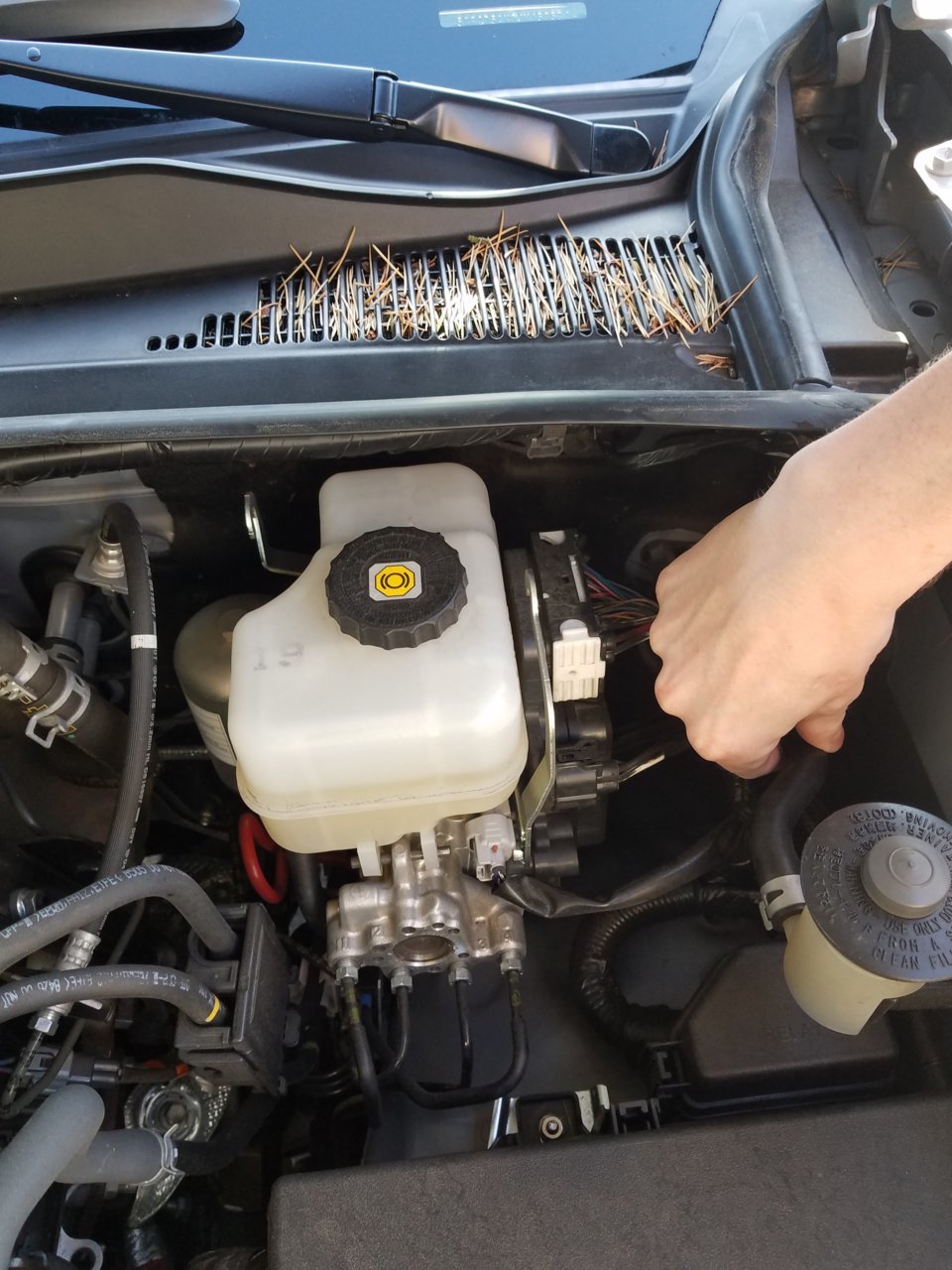

    Got it done in the heat today! And I must say what a difference! I'm pretty sure I got a little air in the system tho but with no one left at work it's fine till Monday.
    I will take a picture of what was different on my 2018 offroad vs. Pdf file for the next guy.

    I'm just driving around now and things got much better!:thumbsup:
    Here's what the 2018 offroad looks like and I'm holding the hose that needs clampped off. 20190726_184717.jpg 20190726_184717.jpg
