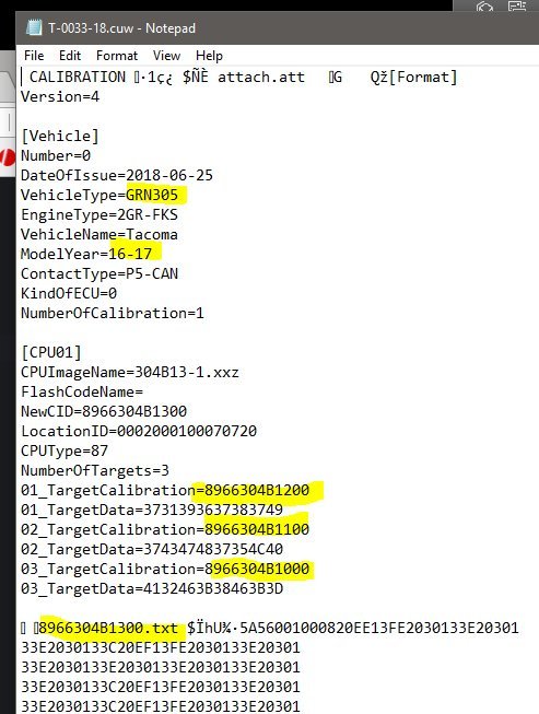

    Sorry, but no. Only the 3.5s seemed to get attention. This is what is noted in the firmware file:
    I would say to hold out for an OEM update, but that is really hard to recommend given some of the responses that folks are getting after calling corporate.
