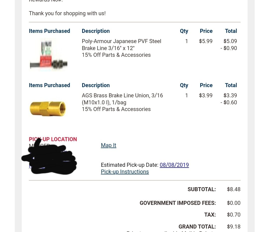

    PepBoys has the 2 parts to do the ADM mod too. Less than $10, parts are in route:
    I wasn't planning to do this mod but it looks very simple so it's on my list. Thanks everyone for the info.

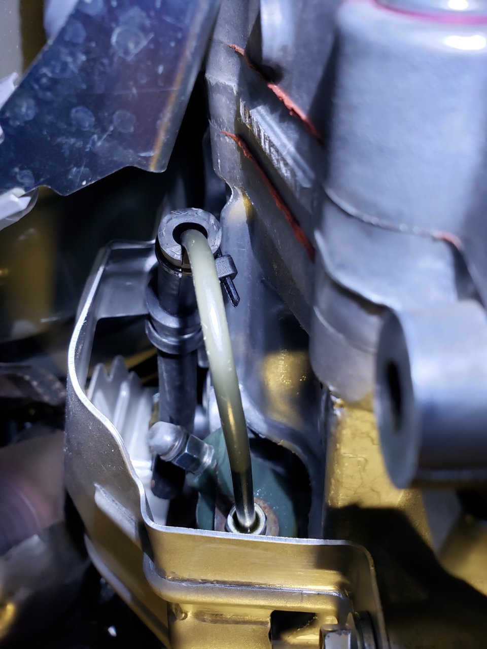

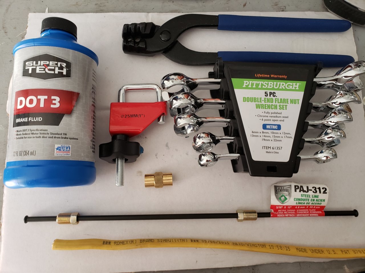

    Completed the ADM mod today. Member lapoltba gave me some good advice - thank you!
    As I posted earlier my 2019 TRD Sport AC's clutch felt fine, no issues unlike some earlier models. I mainly did the mod to possibly save clutch wear, and the parts needed were less than $15.
    The mod is fairly easy, 3/8, 1/4 ratchets and flare wrenches are your friends here. I used a piece of romex as a template and a HF brake line tool to form the 90deg bend. If you buy this tool you will need to smooth out the grooves with a round fine file, the groves are a bit rough. The 180 bend is easily done by hand. The front drive line does not need to be removed though I did remove the catalytic converter brace.
    I opted to secure the new line in place with an insulated clamp to one of the heat shield bolts. I also placed some 1/4 fuel hose over part of the line as a buffer just in case. A bit more time consuming but it gives me a piece of mind there is less vibration of the poly brake/clutch line.
    Gravity bled the line, topped off with Dot 3. The Walmart brake fluid meets Toyota specs.
    Test drove the truck and the clutch release is still out near the end of the pedal as it was before. Clutch feels a bit more solid and maybe 20% less spongy. No complaints so far. Never had any issues shifting any gears so nothing to improve there.
    Hopefully this mod will prolong the life of the clutch plate though I never wore out the clutches in my previous Toyotas (unlike previous GMs and Datsun PUs) . Looking forward to switching the MT gear oil to Redline next month at around 4k miles.
    Junkhead, CygnusX191, mtip and 2 others like this.
