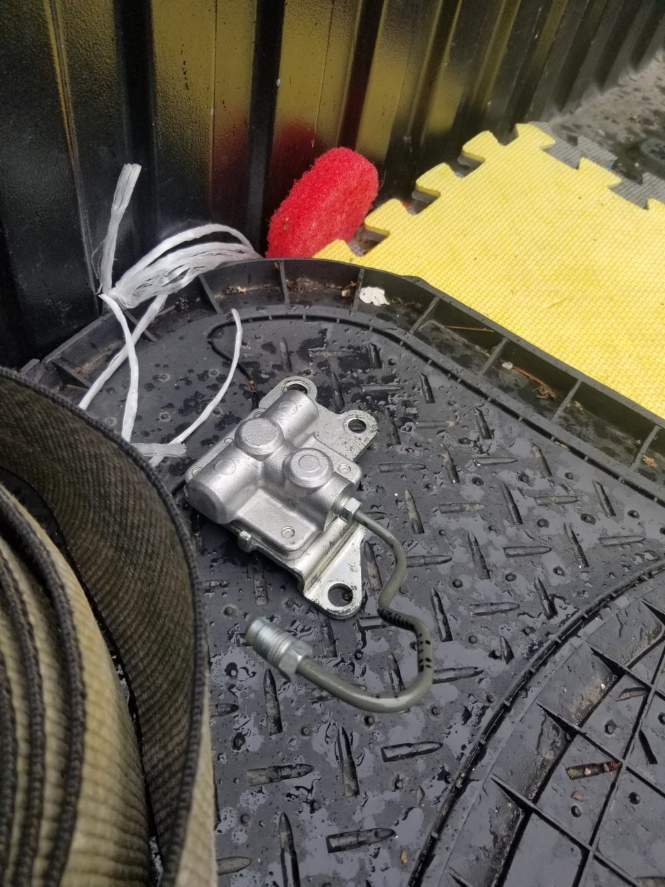

    Just removed mine and took it for a ride.
    Wow! Soo much better, i wish i done it sooner. Shifts are smooth everytime, and a crisp pedal feel, im so happy ! :D
    Thanks to fellow TW MT members and to @Trident904 for the kit.
    I highly recommend this mod!!!
    :burnrubber:
    Norton, CygnusX191, pinochle and 4 others like this.
