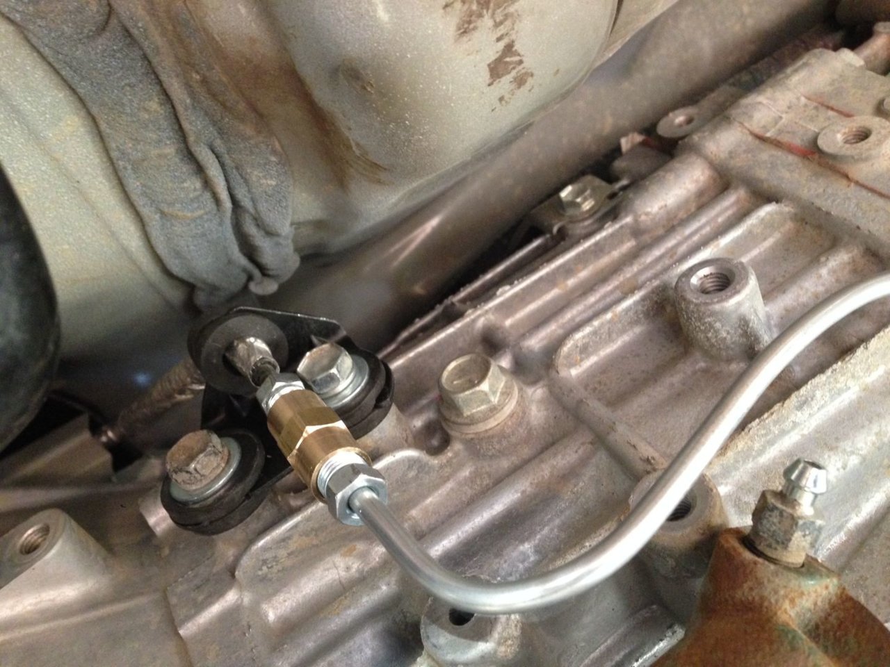

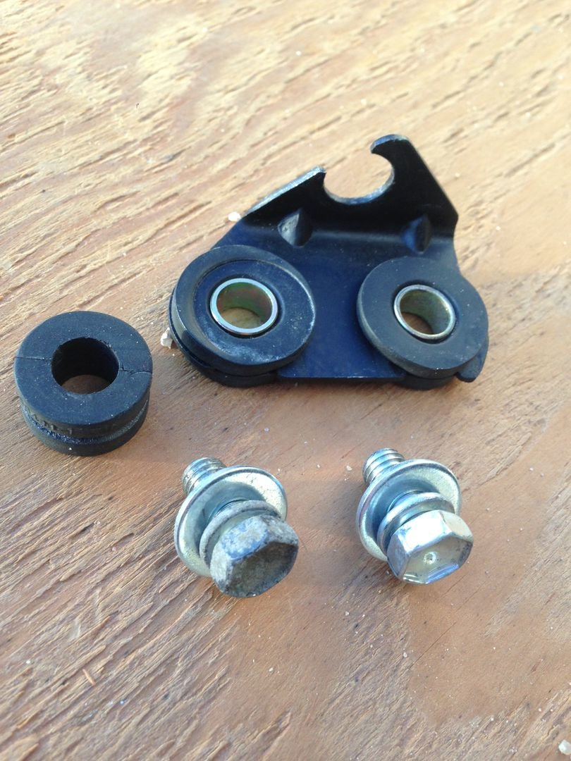

    Finished mine today. It was a little challenging getting the double inverted flare right but after a few practice trys it came together. I salvaged the Toyota sleeved M10x1.0 fitting for the slave cylinder side to prevent leaks as stated in the first post. I went with 11-1/4" for my line length.
    I had never done any brake or clutch line work but I read somewhere to fill the line with sand and make your bends to keep it from deforming or kinking. It worked great. I blew it out with air after to make sure I didn't add any sand into my system!
    I modified a bracket from my GT-Four's old cruise control actuator. It was exactly the right spacing for the existing bolt holes on the transmission. Didn't have much play to begin with but it will add some extra support offroad.

    Thanks to everyone who contributed to the research and instruction on how to fix our clutch feel issue.

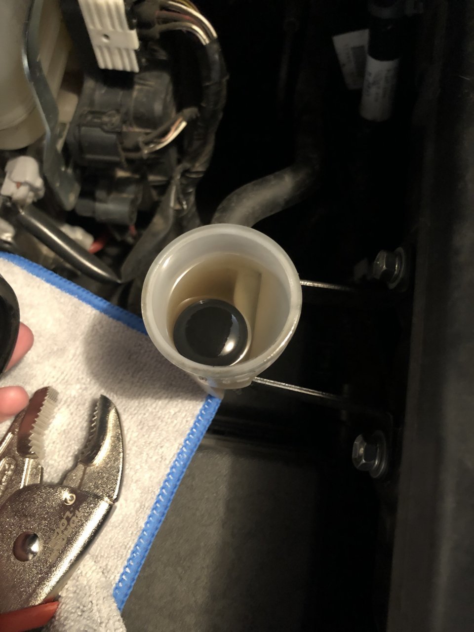

    So I’m about to start this, is there supposed to be a floater in here? I just had the squeaky clutch pedal TSB done, wouldn’t surprise me if there was some fuckery afoot...
  11. Oct 14, 2019 at 10:15 AM
    #1251
    tonered
    tonered [OP] bartheloni
    Sep 25, 2017
    #231055
    31,267
    tony
    Lynnwood, WA
    I believe a couple other folks with ORs said that was in there. I have no idea what it does.

    This magic pill is suppose to float on top of the fluid. The reported purpose is that there is less surface area exposed to the atmosphere, therefore less exposed and susceptible to moisture absorption.
    I am not sure of the legitimacy of this story, or of its effectiveness, (if true). Just reporting what I have heard in the past.

    Interesting, but! The reservoir is going to continually pull in air as the clutch wears and as atmospheric pressure and temperature changes. I suppose that it can't hurt.

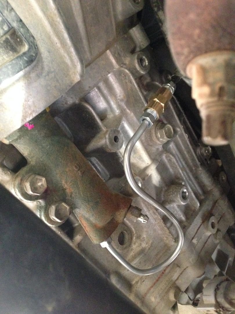

    I don't think you needed to pull the skids. Look just inboard of the left secondary cat.
    Probably the best location pic from the 1st Post:
    You can see the cat flange, driveshaft, clutch inspection cover, and where the accumulator was. The slave cylinder is hidden by the shaft.
