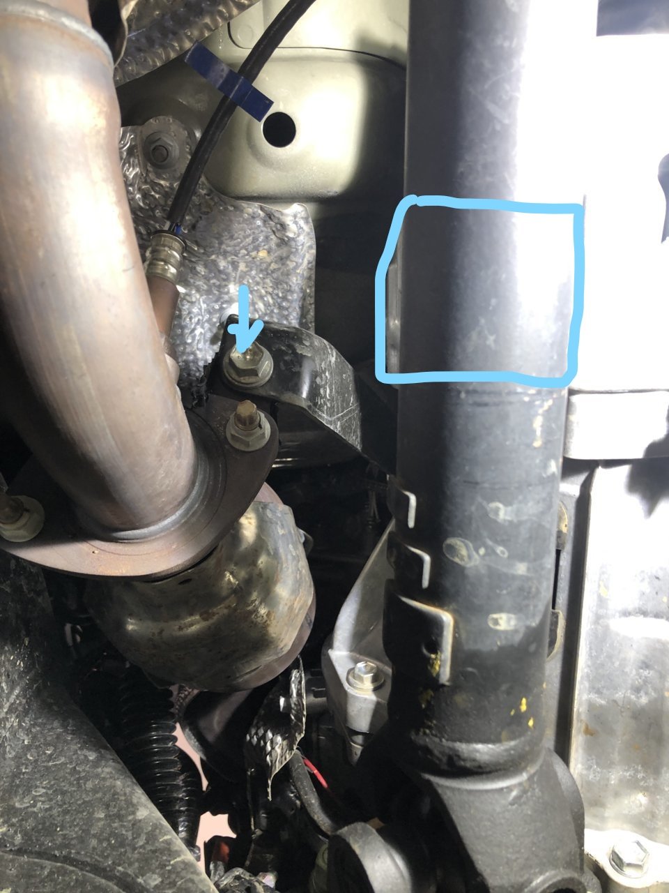

    The square is the heat shield that you need to pull that is on the other side of the shaft.
    To reach the upper bolt on the shield and get room to work, pull the cat support (blue arrow). There are two more bolts up higher and are infinitely easier than the upper shield bolt.

    How in the name of lucifers meaty foreskin did you get the top 2 support bolts off?

    Box end wrench. The ratcheting kind are even better.
    Getting those out are wayy easier that the top shield bolt. Typically, it was the bolt on the cat flange that stopped folks from getting the cat support out.

    If you can, link up two box ends for leverage.
    It can be done with the cat support in place, but there would not have been enough room for the line wrenches on the upper fitting and my hands.
