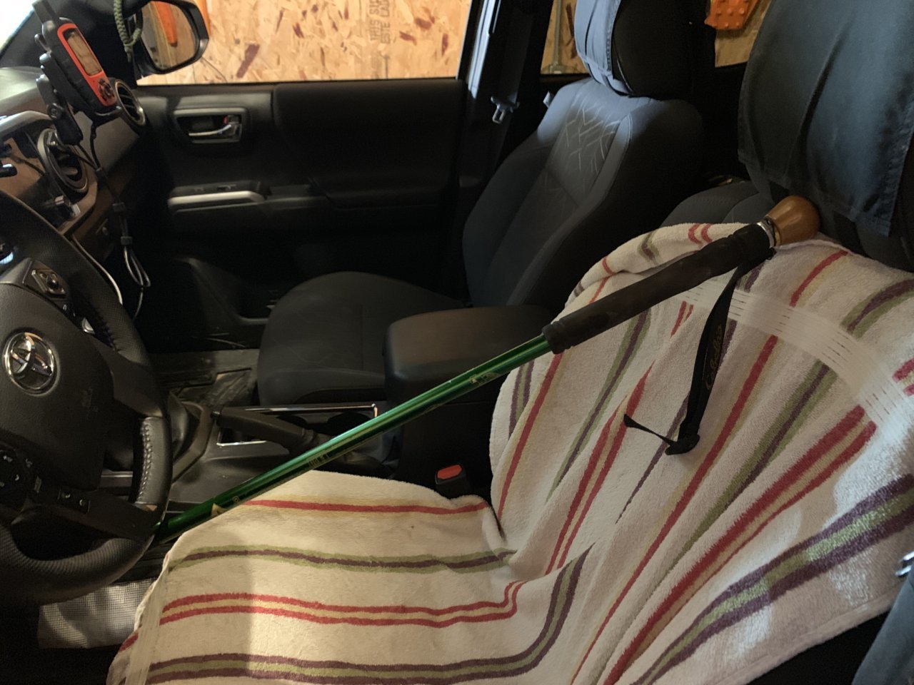

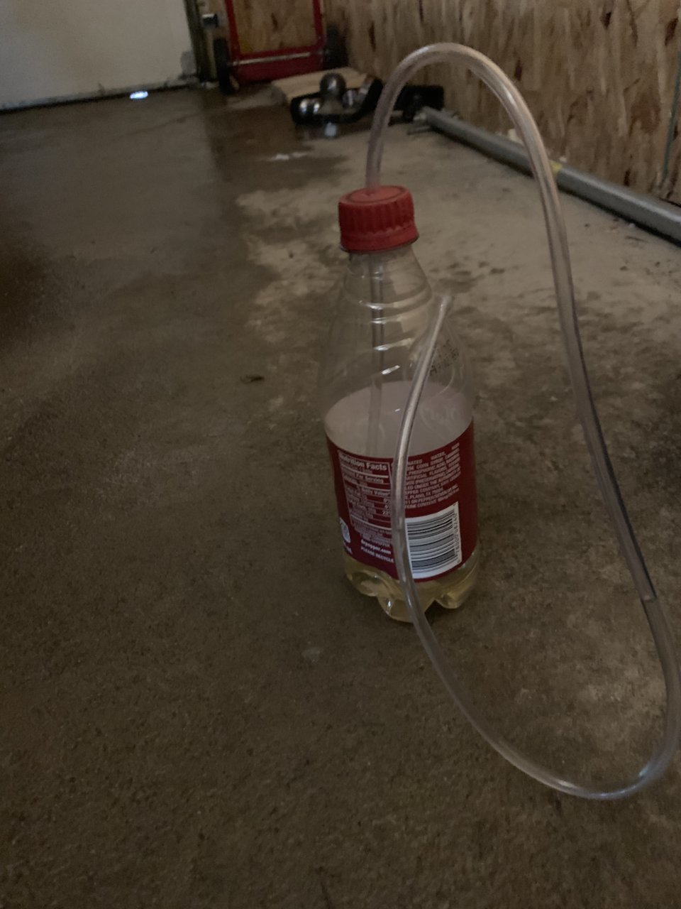

    currently in the process now...after I open and close the valve and remove the long stick holding down the clutch pedal, it stays on the floor until I reach down and pull it back up, then I pump a bunch and repeat the process. Is that correct? Once I push it back down, and crack the valve, I do see a good spurt of fluid, then nothing. Should I close it before the “nothingness” happens? The reservoir is staying between min and max each time, I’m only having to add a little bit. I’ve done the process twice now but the clutch still has a brief period of sticking before it pops up when I’m doing my leg workout.

    I'm betting the "nothingness" is the air coming out. I'd keep going till you consistently get fluid. Be sure to keep the reservoir full, I wouldn't let it get to min personally.

    Wouldn’t that mean it’s a shit load of air in there? I tried just crack it this time and stopping before the “nothingness”, going to drive it around the block and see what happens. Pray for me.

    If you are doing it without a helper, close it mid squirt.
    The pedal staying down is normal.
