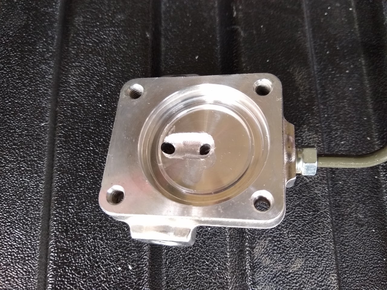

    Doesn't anyone do the dremel mod?
    I found it super easy, just gotta make sure the accumulator is cleaned out well before re-installing.
    Meh :notsure:
    Shellshock and tonered[OP] like this.

    Being that it is just two drilled ports, cleaning should be easy with just brake cleaner or a pipe cleaner if you have any doubts.
    MOC221_[QUOTED] likes this.

    I have a dremel and have seen mentions of it but didn't see a guide on exactly how much material to remove, where to remove it etc. It's not listed as an option in the 1st post of this thread either.

    Yep, and compressed air (with proper PPE!).

    ToC Number 8 and the 9th pic down:

    I made my cut between the ports more defined (almost vertical sides). You can easily make the "channel" between the ports as deep as the diameter of the ports themselves. Plenty of meat there to cut into.
    You just gotta be a bit careful to not damage the lip where the O-ring seats.
    ChouDawg and tonered[QUOTED][OP] like this.

    Ah I totally missed that, thanks for pointing me to it. I saw on post #297 that it seems the port channel is one part of the fix but the inlet and outlet of the accumulator also have built in restrictions. Did you guys do anything with those?
