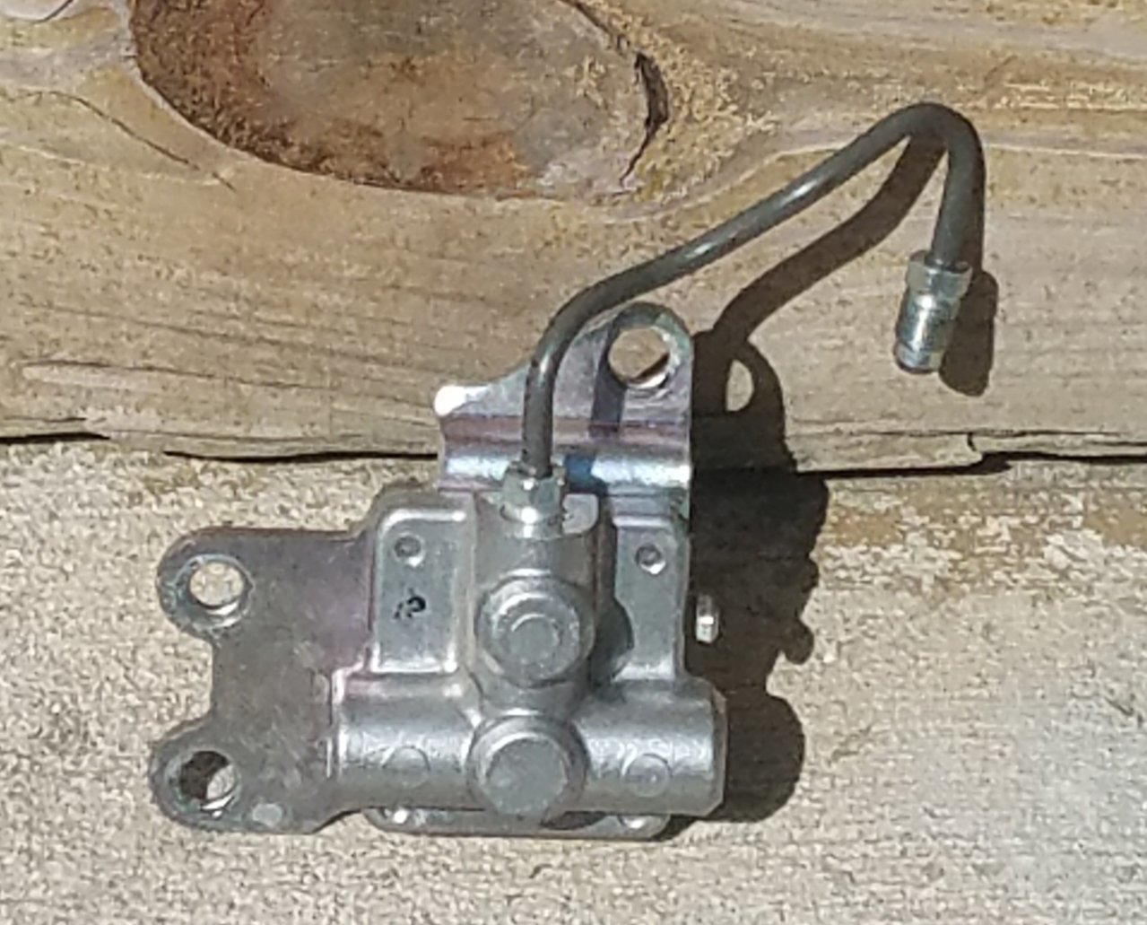

    Going the dremel route doesn't look so bad I guess. Stealthy too. If I mess it up or don't like it (not likely) I'm kinda burnt though.

    If you mess it up, you can just go the hard line route. Also, there are plenty of accumulators lying around on folks' shelves.
    Just draw away from the port near the seal lip. You don't need to deepen the far side of that hole, just create a deep channel between the closest points.

    Well, there's one more Taco out there without an accumulator. Purchased the kit some time ago, but finally got to install it Sunday. Gravity bleed seemed to do the trick, but did also bleed it by pumping the pedal. Clutch feels more consistent on the engagement.
    A big thanks to all the folks that shared their install pics & tips. I think I spent more time on re-installing the exhaust hanger & heat shield.
    6 gearT444E, Junkhead, C41n and 6 others like this.
