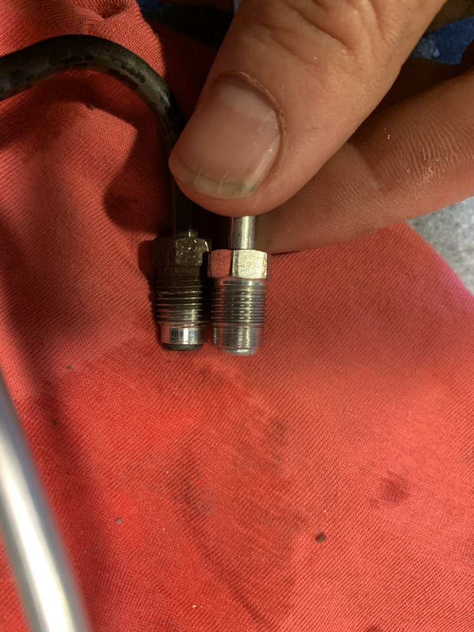

    For anyone who may experience a leak with the slave connection or would like more insurance with a pre-made line without a unthreaded lead fitting. The leak is caused by the slave cylinder only being threaded partially to allow for a unthreaded portion of the fitting to make the seal. The Toyota fitting has quite a large area of unthreaded lead so I would recommend matching your fitting. Using a dremel (or file), tape to protect the threads, M10x1.0 die and a calliper to match diameter you can produce a matching fit.

    The flared end of the line makes the seal, NOT the threads nor the fitting it self. The fitting sandwiches the flared part of the line against the “cone” inside the slave cylinder.

    Yes, but the slave cylinder in the case of our trucks has a fairly deep unthreaded portion that is narrower than the threaded portion. The flared line can't mash against the cone properly because it can't reach it.
    I have experienced with this particular leak issue, and had to re-use my original fitting.

    This was on the ol ginger, and I did give it as much torque as I dared.
    Waaaaay to much to just seat a fitting like this. When I backed it out, you guessed it... the last few threads were being mashed. I didn't want to risk fucking over the slave cylinder.

    Ahh gotcha. I had a difficult time comprehending @loosegrip ’s post.
    FWIW the “pajx-312” part number from Autozone and other places does not have this issues.

    thats the one I have.

    Yeah I had a generic fitting that didn't work out too great lol.
