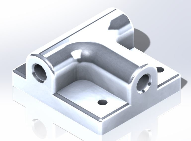

    The problem with making a block is that there are press fit brass seats. Making two of those with precision and the block would end up being more expensive than the other methods.
    Of course, if you have another thought on that, feel free to go for it.

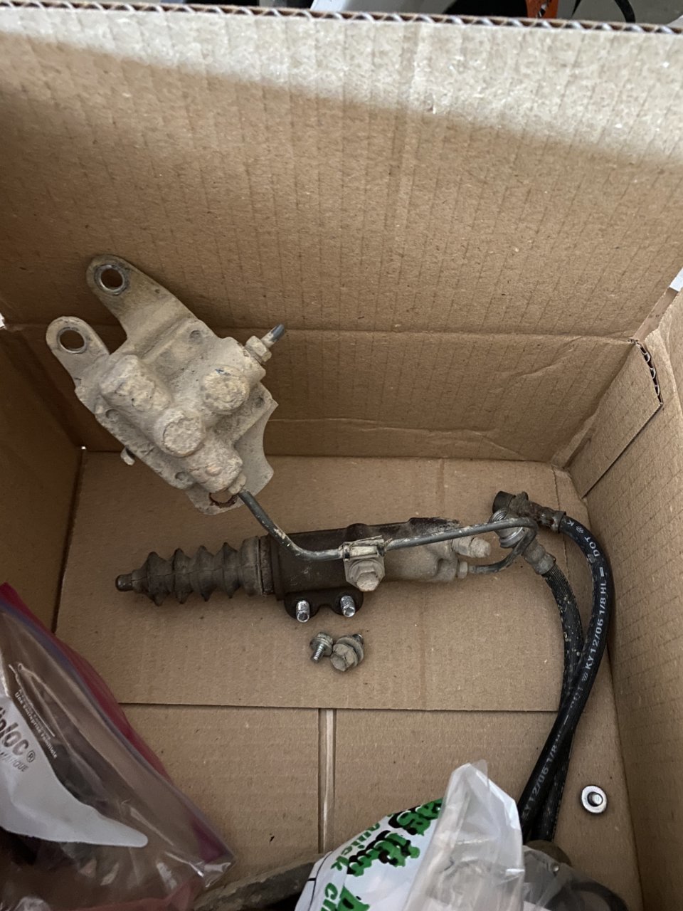

    If anyone is willing to part with their old take-off I would still like to give it a look.

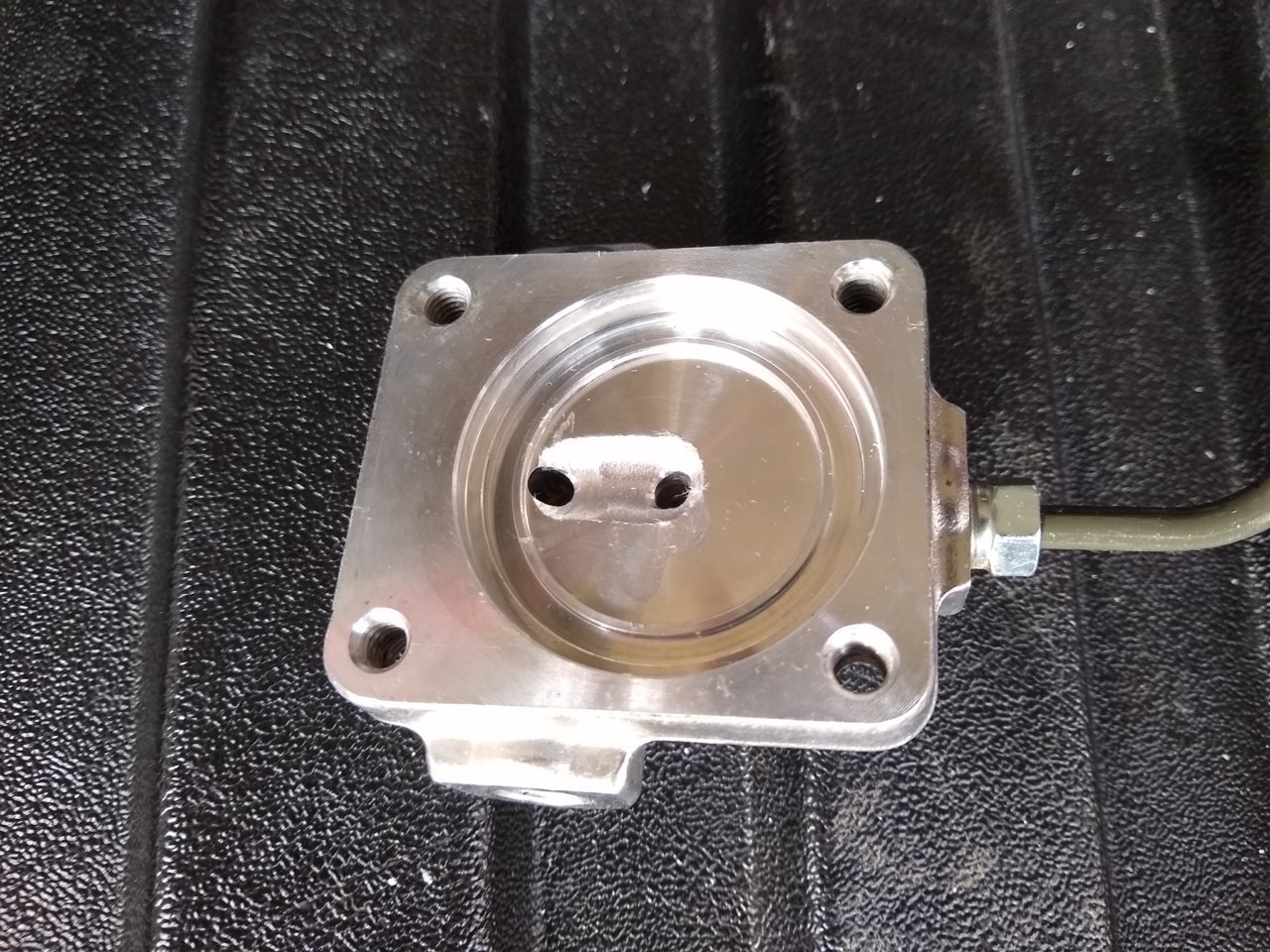

    Hey everyone, I'd like to try to do the ADM tonight. I'm pretty confident with a dremel so I think I want to go the stealth route and hack my accumulator.
    I just need some dot 3 fluid for when I bleed the clutch right? Any other tips? I'm trying to keep it looking factory in case of warranty work. I know y'all get tired of answering the same thing over and over I just want to make sure I'm not missing anything. Thanks!

    Yep. If you clamp the feed line to the master, you will probably not lose enough to notice. Have some brake cleaner or compressed air on hand to clean out the shavings.
    You'll also want a 10mm line wrench. Don't use a standard box end.

    Just make sure you clean it out REALLY well. You don't want any of the metal chips floating around in there after you reassemble.

    Reconnect the upper fitting first. With the drips that you will be getting out of the upper line, it will help purge the air down the line instead of letting it bubble upward.

    So i did it! I didnt know where to clamp the metal line.... So i emptied the accumulator lines all over the car port. I already love how it shifts and im im pre certain i have air in the lines. Anyone have a good clutch bleeding video?

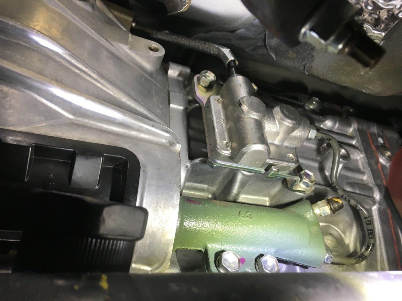

    In case someone already hasn't stated it before, the accumulators for 2nd gen and 3rd are different, although probably act the exact same. 2nd gen (2005-2015) is PN 31490-60151, 3rd gen (2016+) is 31490-35100. These look similar from 10 feet, but notice the port locations.
    2nd Gen
    3rd Gen
    They appear that they are the same casting but different drilled port locations but I can't be sure without comparing both. I went about trying to find a bolt-in replacement for these before knowing this. The donor piece I was looking at was a 2nd gen accumulator and I have 3rd gen truck. Does anyone have a 3rd gen accumulator that they would like to send me for me to double-check measurements? I'll pay shipping.
    A bolt-in replaceable piece appears doable with an aluminum piece and brass inserts for under $100 as a direct bolt-in delete option. I even added some additional milled area to make it look closer to the original part:
