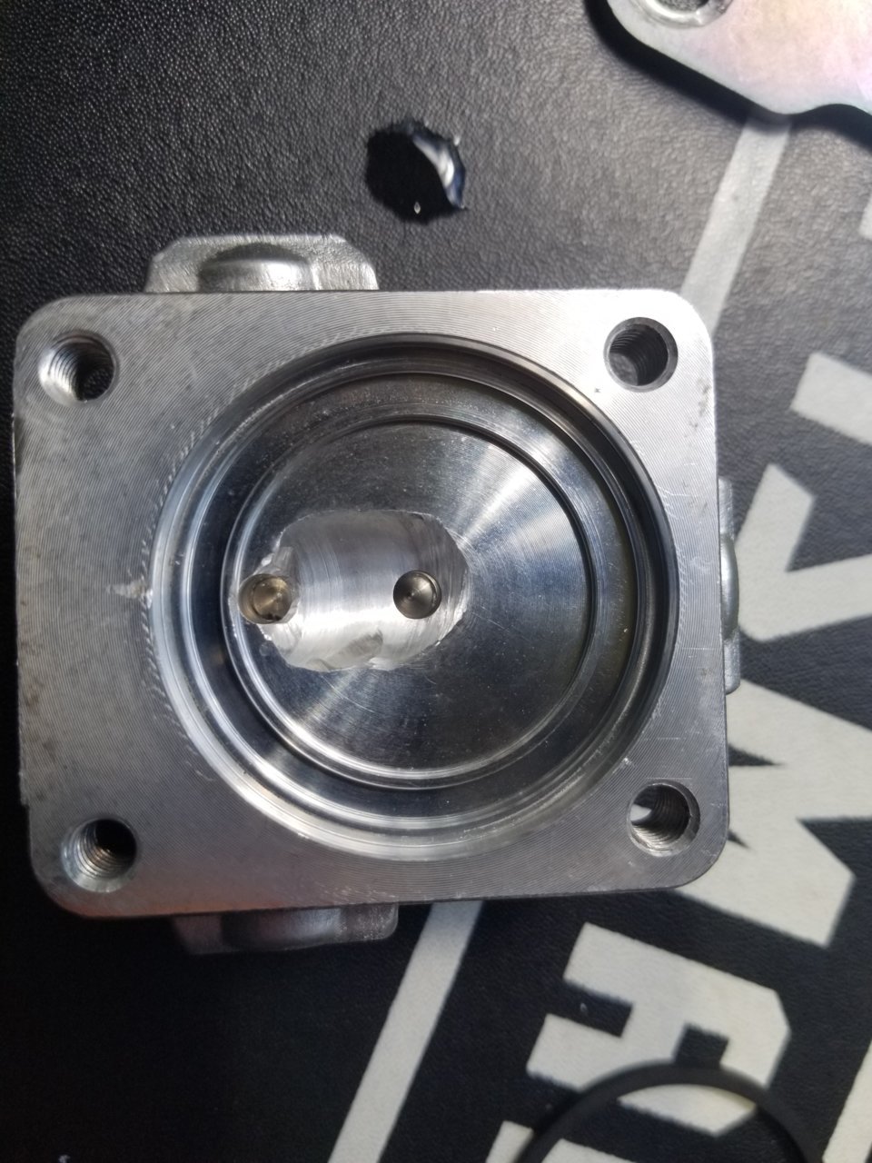

    Yep, I'd say that's successfully hacked!
