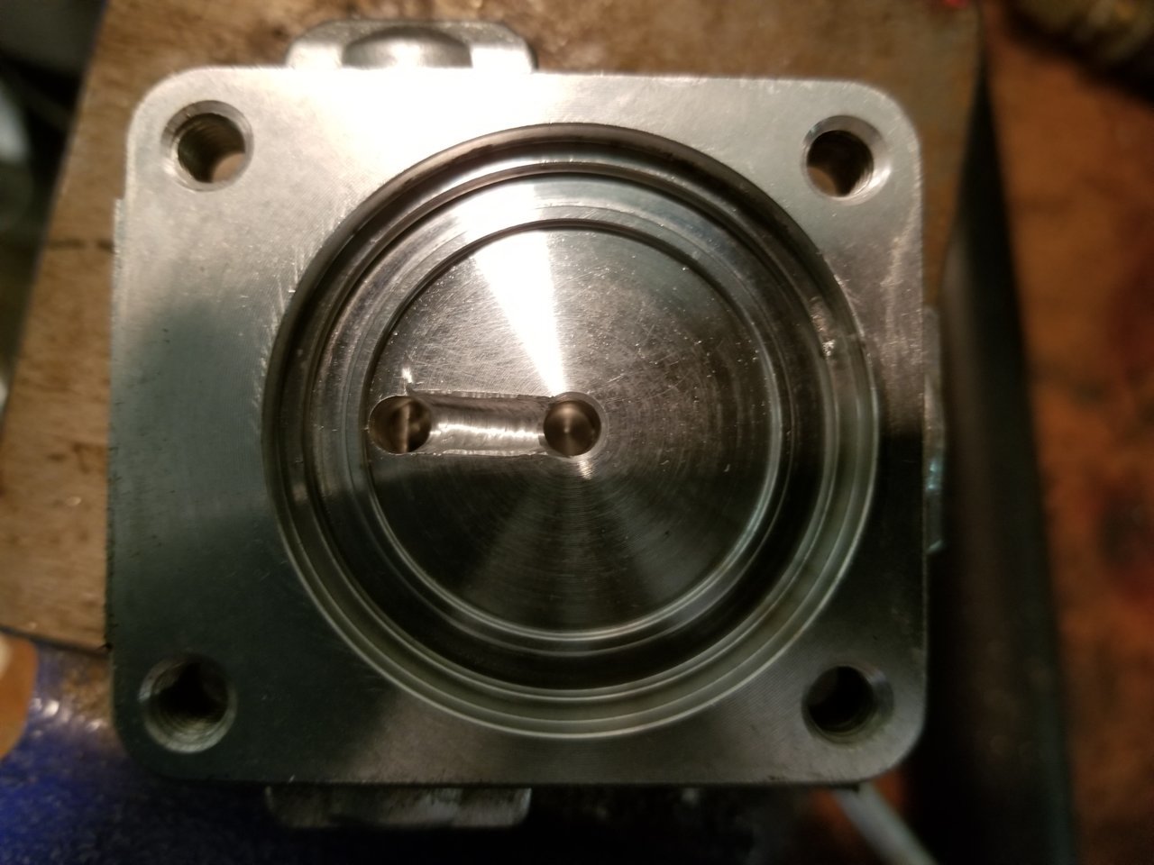

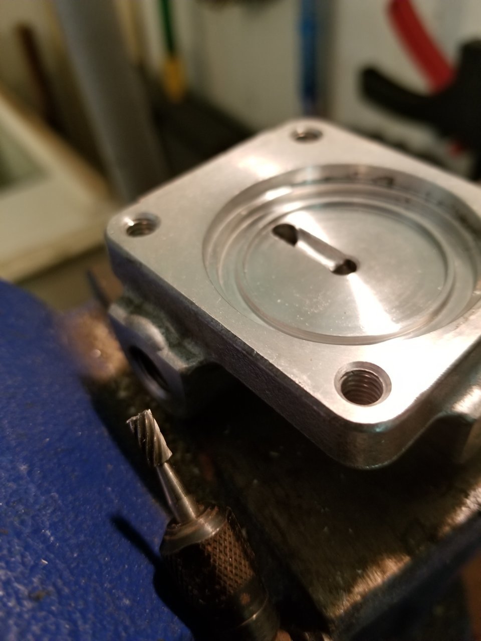

    So the dremel method is just that? Put it all back together and no additional hardware?
  3. Aug 31, 2020 at 8:30 AM
    #1803
    tonered
    tonered [OP] bartheloni
    Sep 25, 2017
    #231055
    31,339
    tony
    Lynnwood, WA
    Yessir. It has been verified that there are no hidden features to the accumulator. The functional part is just that metal diaphragm and seal. So, a good cleaning is all that is needed.
