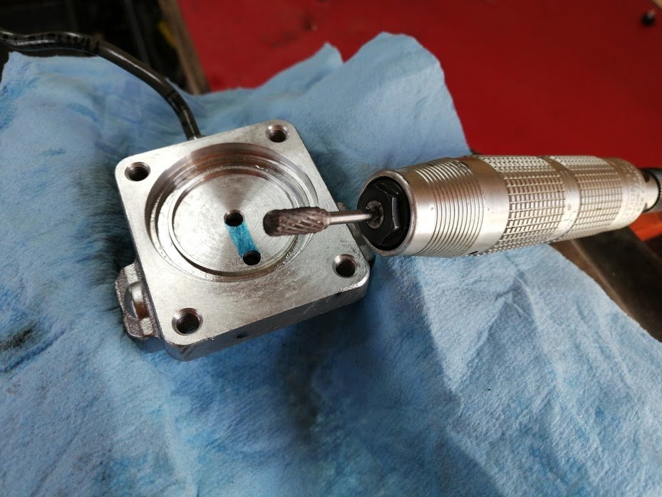

    So does the dremel mod perform just like the full line mod?

    Yes. All the mods shown in the 1st Post work exactly the same, just look a bit different.

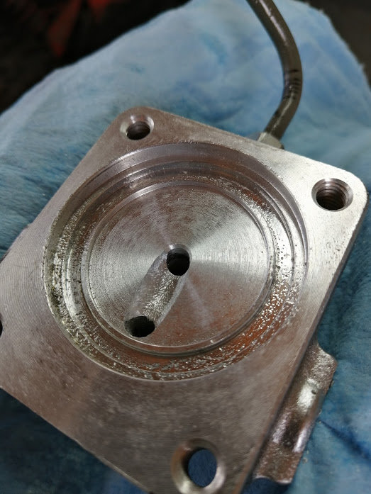

    I finally did this today. I actually started with a 12" brake line and coupler to try it out before modifying the accumulator. Very happy with the results, but I did notice a difference between the bent brake line and the modified accumulator, clutch grabs a little lower with the modded accumulator, don't really know why.

    The engagement zone should not change with the ADM, regardless of method. With no other changes, the only explanation that I can think of is air in the lines.

    I would venture to guess there is still a slight dampening effect with the Dremel mod vs the bypass.
    If you think about it the accumulator is still going to disperse fluid in a non linear fashion, just way easier.
    I did the Dremel because it was free, and after doing it the clutch feels like a regular clutch instead of that weird shit. So at the end of the day, Dremel it.

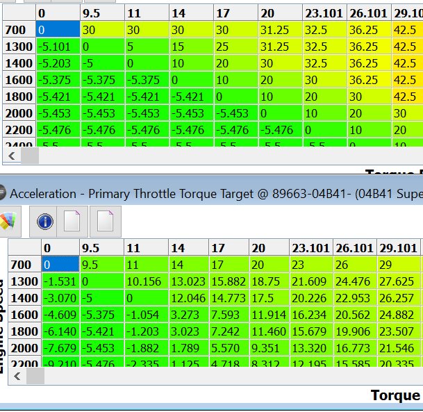

    if you have VF tuner i found that changing the settings in the primary throttle command to help.
    if you look, the throttle has a big jump then as the RPMs rise (which they do immediately) then it falls off.
    i smoothed this out, it helped a ton. however, it does negatively affect the ability to rev match from low rpm (1000-1500)
    top is stock and ovtune
    bottom is mine (please go to the vf threads for anything further on this as we dont want to muddy this thread up)
