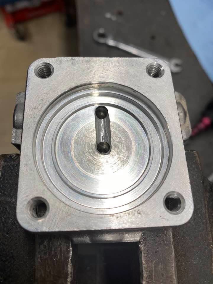

    Blueberry.Taco
    Blueberry.Taco blueberry.taco (IG)
    Sep 14, 2020
    #340806
    887
    Ryo
    Fulltime Overlanding
    Long travel house on 35s with a custom aluminum utility bed and FWC
    some welding required
    just did this, super easy.
    It's been a while since I've worked under a stock vehicle, amazed at how much room is under there.
    anyone complaining about not getting their hands or tools to fit under there haven't worked under engine swapped vehicles enough!
