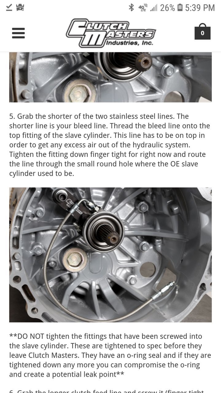

    The picture you have here posted, is it from there Trow out bearing upgrade?
    I wounder if they can help you? I would try the Toyota but guy and show him, but if there scratching there heads at least there is somewhere else too look.
    Let us know what you find
  11. Dec 21, 2019 at 5:35 PM
    tathambenjamin
    tathambenjamin [OP] Well-Known Member
    Jun 29, 2017
    #222703
    297
    ben
    2008 4Runner SR5
    -2.5/1.5 spacer lift -270/65/17 Cooper AT3
    The picture in first post is a google image, not even sure if it's a tacoma. The link in the first post is to picture from the clutch master hydraulic internal slave upgrade for the squeaky TOB.

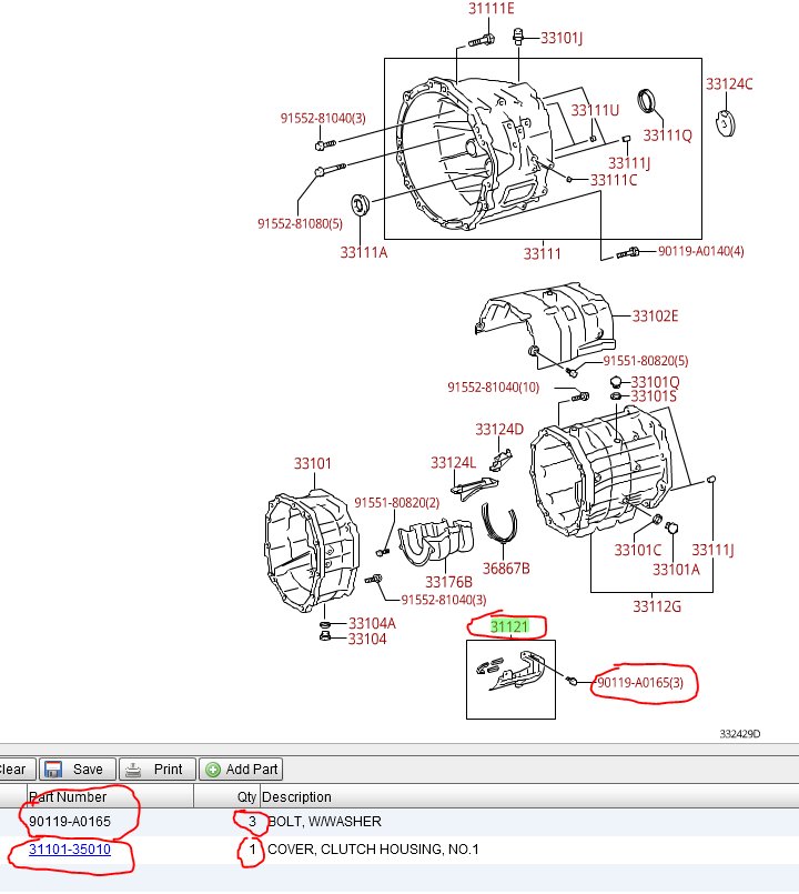

  19. Dec 22, 2019 at 10:08 AM
    #19
    tathambenjamin
    Jun 29, 2017
    #222703
    297
    ben
    2008 4Runner SR5
    Not sure what you are showing here- I looked up those part numbers. The one on the bottom (31101-35010) is a metal cover. The 90019-a0165 is a bolt and washer. I still don't see anything pictured or with a part number that matches the rubber cover for the RA60F

    He needs the clutch fork boot.
