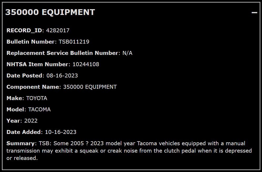

    I see the 2020-2023 TSB on the NHTSA website from August 16, 2023. It's just a revision from the TSB in 2019 - they're calling it "Rev1."
    The only change to it vs the 2019 TSB was a new master cylinder. Went from 31420-60032 to 31420-60033.

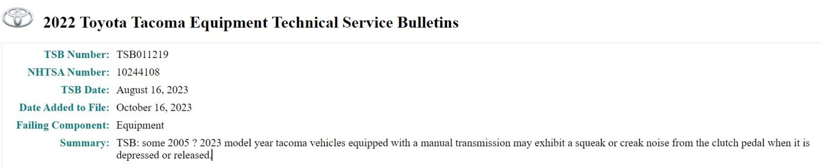

    Here is everything I've found. Bringing it in again on Saturday....we'll see...
