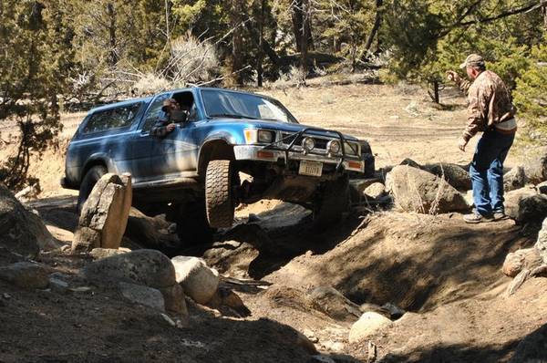

    Check this out makes me proud to own a Toyota. Found this on the MT 4x4 Forum[​IMG]
