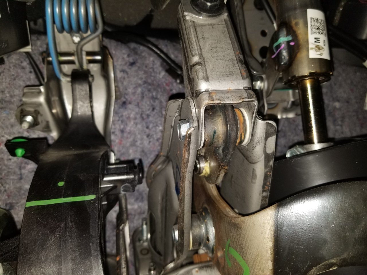

    Mine has creaked squeaked and clicked from day one. The clicking comes from the return spring (spring steel) moving inside an eyelet on the pedal. Good luck getting it addressed, mine is terribly loud in humid weather. 3 trips to dealer and I gave up after having a "field technical supervisor" come up from boston to apply grease and tell me it's as good at it will ever get.

    So I wonder what a fix for that would be? Since you know where it originates, maybe it’s something an owner could figure out a way and address.

    I'm almost positive a piece of brass shim stock would work great there. Just not sure how long it would last. And it's tough to find anymore short of packs big enough to do all the mt tacos out there.
    So the part I'm talking is the blue spring top left corner. Thing that's the groan/clicking sound is spring steel under tension being "ground" against the plastic pedal. Move the pedal with your hand and feel where it comes from. I haven't been ambitious to fix it myself, though I have asked a lot of random old time repair guys if they have a small piece of shim stock and haven't found any, hardware stores around me carry paper thin stuff
    High pitched squeaks I think came from lack of lube on the pivot.

    I took a look at all the pieces in the pic yesterday and I agree it may very well be spring related. The issue with mine I guess is that it is inconsistent so it’s hard to recreate by just pressing and depressing the pedal by hand.
    I was gonna try and lube it, but I figured I might as well get Toyota to mess with it first on Wednesday of next week. . If I fixed it temporarily then they definitely wouldn’t be able to recreate it, and say I am crazy.

    i removed my return spring, just simply removed it, the blue one. but I'm not so sure the OP's symptom is the creaking & groaning we're talking about all the time. he's mentioning a distinct click at the end of travel and no groaning, so I'm not sure we're all talking about the same thing.
    but removing the return spring does indeed fix all symptoms associated with the return spring. lol

    After years of experimenting with different lubricants to stop the old barn door sound in hot weather I decided to try Disc Brake Grease on all the pivot points and that has cured the issue, it stays put in high temps.

    100% worked for me as well. had it on for more than a year and no sounds or friction ever returned.

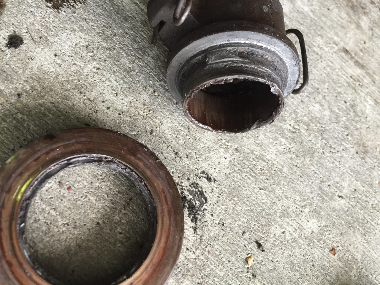

    Opihi59
    Opihi59 Vulgar Boatman
    Dec 2, 2017
    #237486
    362
    Beyond Honolulu
    2016 TRD Sport DCSB 6MT
    Unknown lift, maybe 2" I don't know how to ID it, and would rather set it back to stock.
    I recall having a very distinctive click, both audible and palpable through the pedal at engagement point of pedal travel. It was a broken body of my throw out bearing, but this was a wrangler at 108K miles. None the less, had I not dug into it at the time, I would have chewed thru my pressure plate fingers within a few days. Not saying this is your problem, but it's something to consider. Keep an eye on it lest it becomes something that leaves you stranded.
