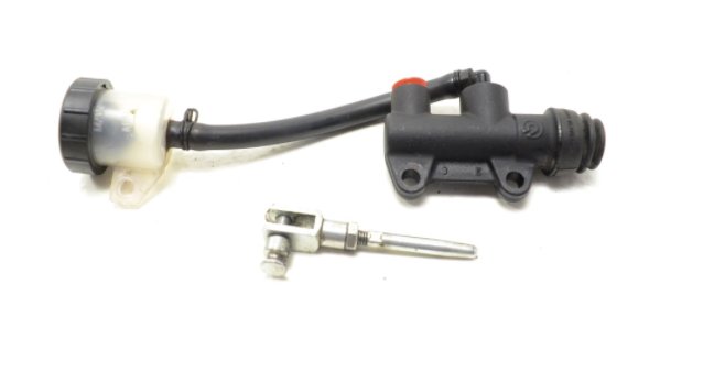

    For the slop, it is normal. I believe, but not 100% certain, that the push rod is separate from the piston. It acts on it similar to the setup on my bike's brakes:
