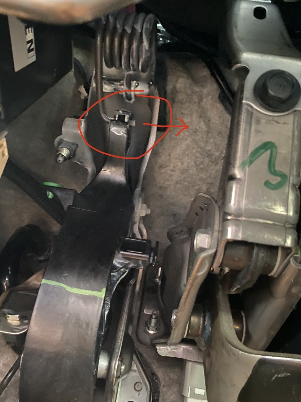

    I found what the problem was. Today leaving the store, a nut and washer fall to the floor from the clutch pedal area as I'm shifting. Come to find, when the dealer put on my new clutch pedal in under the TSB last month, they barely tightened the nut/washer that goes on the bolt holding the clutch pedal sub-assembly to the clutch pedal support. Its on page 1885 of the manual at the top. My pedal had tons of play side to side that I thought was normal and was aiding in the click and noises. Hopefully good as new now!

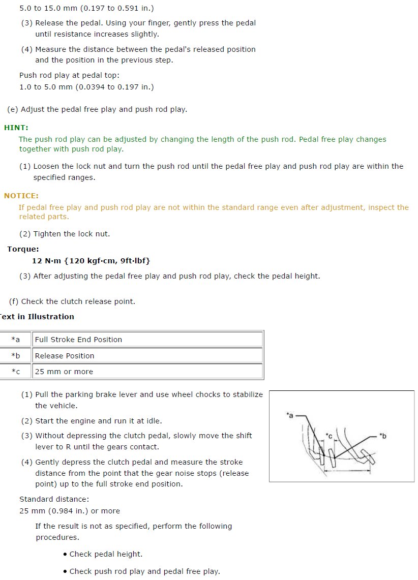

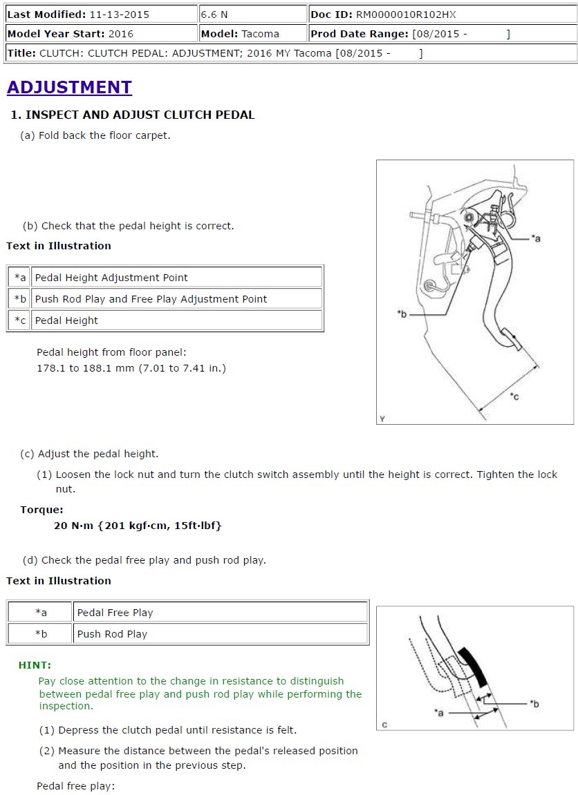

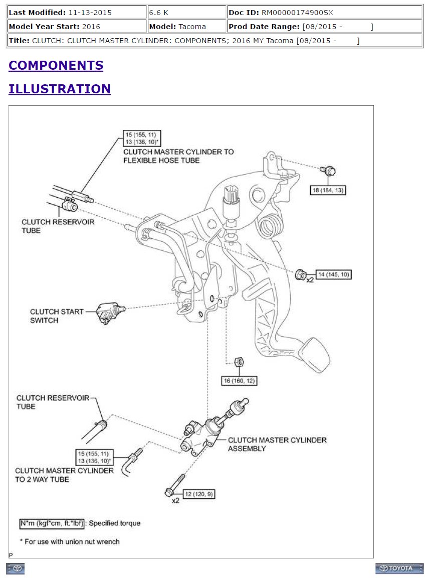

    It might be easiest to check the limit switch at the end of the travel before wasting time at the dealer. See the adjustment info from the service manual posted earlier.
    It could also be the return spring or gap to the master push rod. The push rod gap typically makes noise when starting to disengage the clutch though.
    Edit: Sorry! They were not fully posted in this thread. Service Manual (140mb):
    https://drive.google.com/file/d/1cx5nnlnCzlhI45D1vbBMj1ni983SKdKf/view?usp=sharing

    sorry, just to be clear .. my clicking happens when i push the pedal down .. it clicks right before it hits the floor .. can you clarify if i should tighten or losen the push rod?
  15. Aug 24, 2021 at 8:44 AM
    #115
    tonered
    tonered bartheloni
    Sep 25, 2017
    #231055
    31,247
    tony
    Lynnwood, WA
    The push rod is fully engaged in the very first part of the stroke. A click at the floor is more likely to be the lower limit switch or a pivot that needs to be greased. The stupid, non-linear clock spring goes over center and could be the source of the noise. Either the perches or the coil are touching.

    Yeah. Adjusting the push rod or the limit switch will not help with that.
    The best method that folks have found is to get disk brake grease, because it will not separate or drip when hot, and apply it to the spring, perches, and any other moving part of the clutch pedal.
    The weird part is that some folks get noise in the heat and other get noises in the cold.
