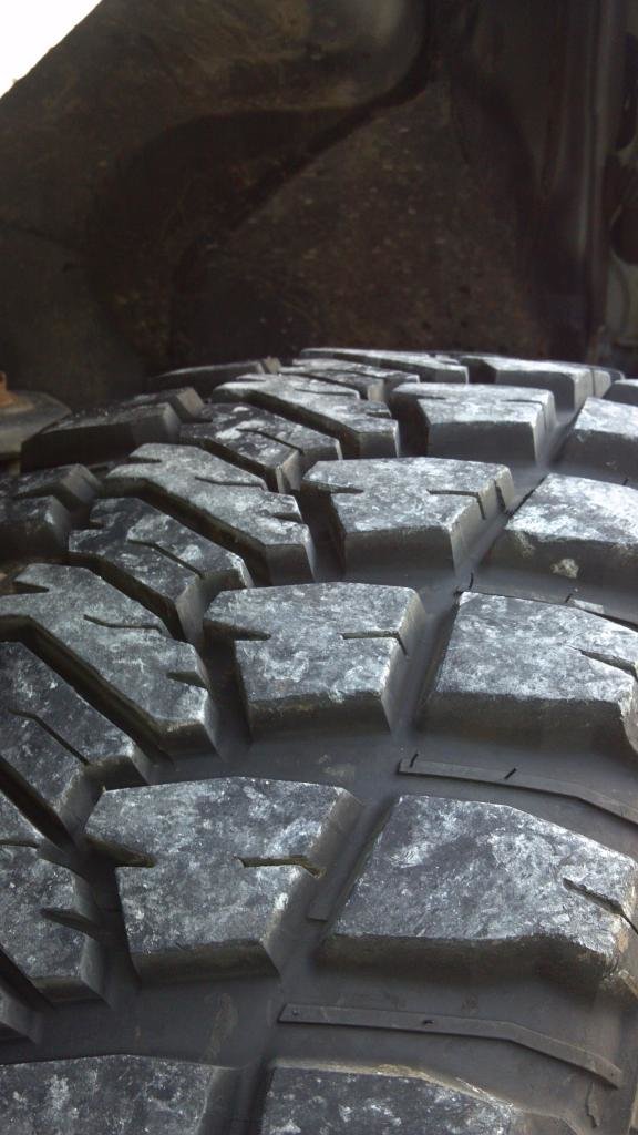

    -At time to rotate the tires (5k-6k miles) I noticed an odd wear pattern that was identical on the front driver and front passenger (pictured below), wear on the rear tires were fine. KM2s however, had perfect wear all around.
    -Less on-road traction, especially in wet conditions.
    On that last point, I don't know for certain if this is at least in part due to the regear to 5.29s? In dry conditions, I sometimes noticed a slight 'chirp' when accelerating out of a sharp turn, which I don't ever recall happening with KM2s. I have also had several occurrences where the MT/Rs would produce little or no traction when accelerating (even slowly) from a full stop... didn't have this issue nearly as much with KM2s. I haven't had the MT/Rs in snow/ice conditions yet so I can't compare this aspect.
    Here is my tread wear on the rear tire after 6,000 miles.
    New spare:
    Rear tire:
    And can someone explain what is going on with this uneven wear on the front tires?? As I mentioned, the wear is identical for driver/passenger. In the tighter tread, the smaller blocks have significantly more wear than than all the other tread blocks on the tire. The wear seems almost perfectly even across the individual blocks. It was suggested that it has to do with the 1" spacers I have on the front, but I had the same spacers and suspension with the KM2s and had zero issues. So, WTF?

    Your front tires are cupping, dude... :eek: That sucks. Cupping could be caused by an unbalanced tire (Did you get the tires balanced when you rotated them?) but most likey indicates a mechanical vibration. Since you're seeing this wear on your front tires, I'm very confident it's a mechanical vibration. You'll want to check ball-joints, bearings and the shocks. I just about bet you the shocks are dying as a result of the spacers... Most of the cupped out tires I see come in at work are a result of old or worn out shocks. It may be time to get a new front suspension, man. As for this not happening with the 33" KM2s, I don't know exactly why, but maybe it's because the larger/heavier tires have magnified the stress put on the shocks, and they're deteriorating more quickly than they were with the lighter/smaller KM2s... :notsure:

    But his front tires are definately cupping. Over-inflation can worsen the effects of mechanical vibrations on the tires, but I don't think air pressure is the culprit in this case.

    I initially left the pressure out as a factor since over-pressure normally results in a bowing, across the tread type of wear, unlike this every other lug on one side of the tire deal.
    I basically did the chalk test when I tried to find the ideal pressure which seemed to be around 29 (about 3-4psi less than the 33" KM2s). And as mentioned the rear tires and all the other lugs on the front tires are wearing even.

    And tires were balanced when I got them installed and also got an alignment (twice).
    I noticed the cupping while I was in Colorado the other day (so around 5k miles), drove home (so total around 6k miles on the tires) and stopped in at Discount who said they won't touch a damn thing that has spacers.:rolleyes: I'll go to the tire shop across the street tomorrow.

    Took the truck in to the shop today. Upper ball joints have play and need to be replaced, partially due to the fact that they rub the coils when the suspension is fully extended. They want $435 for parts/labor. At that price I might as well get aftermarket UCAs and do the work myself. Any suggestions on which UCAs?:spy:

    That tire wear is from bad alignment. Improper to to be exact. I have it too. I ja a half inch of toe out.

    i disagree with the above cupping causes.... cupping on the front tires is common with lifted vehicles. basically.... with the stiffer front suspension when u turn at lower speeds, the suspension isnt compressing as much with weight transfer. this causes the inner edge lugs on the tire to kinda fold and bend aggressively as they hit the pavement.... u can hear the rubber "scuffing" the pavement on some trucks when turning slowly. my duratracs are starting to do it do. and i guarantee im more religious about tires and alignment than anybody here. my alignment is perfect and my tire pressure are too. very hard to get around this cupping with aggressive tires. only way to prolong tire life is to rotate all the time. not just front to back either. i move my fronts in an x backwards and the backs forwards straight.... but like i said hard to get it to stop
