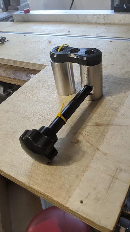

    alright guys, finally had a chance to sneak to the shop and prototype some spacers for the guys with toppers. diameter of the spacer matches the main chain link body so it should look pretty sleek once powder coated and installed.
    had a moment of brilliance while turning them on the lathe, realized the spacer guys could have a way to hold the axle, so i milled a flat and drill/tapped it for the axle. should be able to point it in any direction you want to orient the axle to store when not in use.
    sending this set out to a local Salt Lake rider to beta test with for the next few weeks. if they work, they'll end up as a part# on the website for future customers. anyone that already has a WheelDeal and needs a spacer setup, please PM me and we'll work something out. I want to make sure i'm taking care of you guys that jumped in the pool first. :)
    pardon the yellow zip ties, those are to signify "blems" so they don't get sent out accidentally. but they're awesome for testing.

    I'm just going to say it.... That's friggin awesome!!

    I've got some positive feedback from the guinea pig for the Leer shell spacers @ 2.5" long. looks like a 29 x 2.5 tire/wheel fits great with just a little room to spare on the windows. pics below of the prototype, final versions will be powder coated to match. and the extra threaded hole in the spacer for mounting axles seems to be working exactly as intended.

    feedback from my beta tester is that they're working brilliantly. i need to get a few more sets made on the lathe so i can get them on the website for guys with toppers. i think they're going to be about $20 since there's so much darn material in them.
    @calzonical send me a DM and i'll get you a set working.

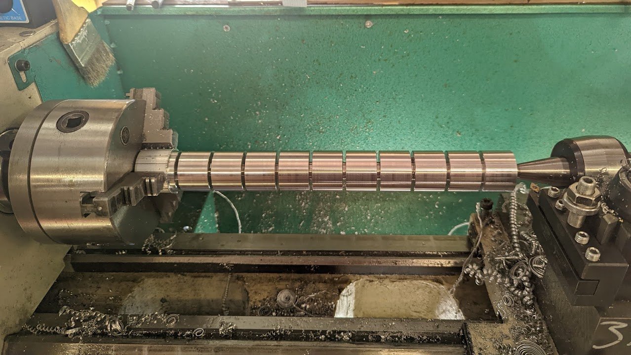

    first batch of 1" spacers on the lathe. they still need powder coat and i still need to get the 1/2" spacers done.
