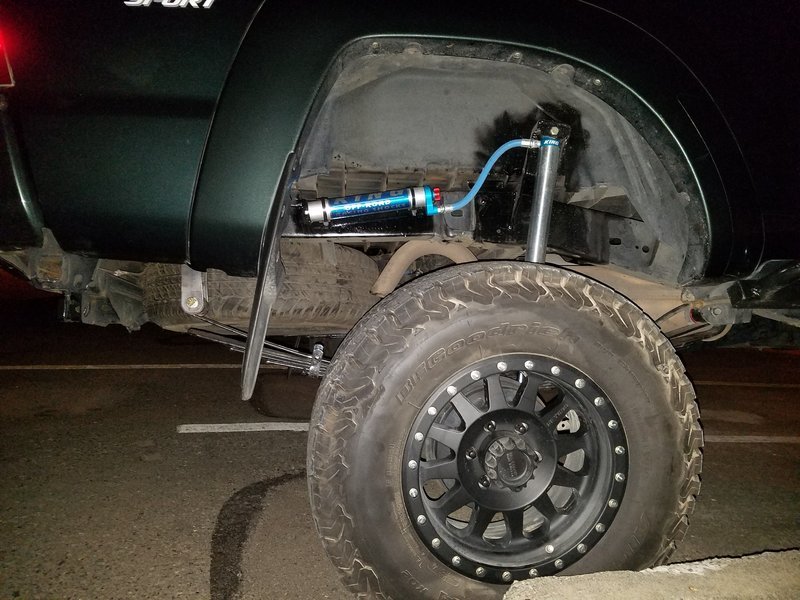

    So I finally finished my set up and have pretty solid flex but.... quite a shitty ride at speed and hardly any compression. How much up travel do you guys have with a spring over and shackle flip?
    Alcan 2 inch lift w 200lb and half inch longer at shackle end
    Archive garage shackle flip with 6inch shackles
    Bamf relocate and 2.0 12"kings
    Wheelers superbumps set to just let the springs go negative a bit
    Edit: I still need to add some lift up front to even things out

    If you have 200 over springs and an empty bed it is going to ride like shit buddy. A 200 over leaf pack is intended to maintain ride height and support / flex accordingly with that 200 lbs of weight. It would be the same result if you took out your 600lb springs in the front and put an 800 lb spring in...
    The only way to make expo springs ride comfortable for a daily driver is to always have that weight in the bed.

    With the bamf kit, shackle flip and longer shackles, at ride ht I am sitting at just about 50/50 up/down travel on the shock. Took a little playing around to get it there, but it rides beautifully at speed and has plenty of flex. A little rough driving around town, but I've said it a few times before, you're not doing all this work for that, you want it to perform offroad.
    I'd agree with @Evenflow and day you either need to add weight permanently to the bed, or go with some different springs. Otherwise you will never be happy with it.

    And I'm not sure how you mounted your lower shock mount or bump stops, but you should be nowhere near them with a quad in the back. Especially with that stiff of springs. I've ran with bikes/ quads/ fully loaded before and not been near the bumps. So something doesn't sound right unless it was a 1000lb quad

    At full flex i have about 11.75 inches of shock rod showing and on the compressed side around .75 showing.
    My lower mounts are about even with the axle centerline. At ride height, no weight in the bed i only have around 4 inches available up travel. I built a 2 3/4 bumpstop extension to keep springs from going too negative.
    I did buy a second set of axle mounts because i originally thought they were too high but it seemed to work with the bump setup.
    Can i see a pic of your lower mount? I dont want my shock to be the limiting factor here but i think without longer shocks it is.
