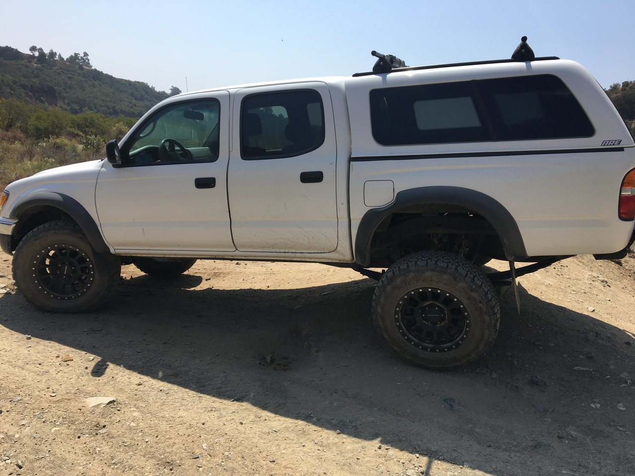

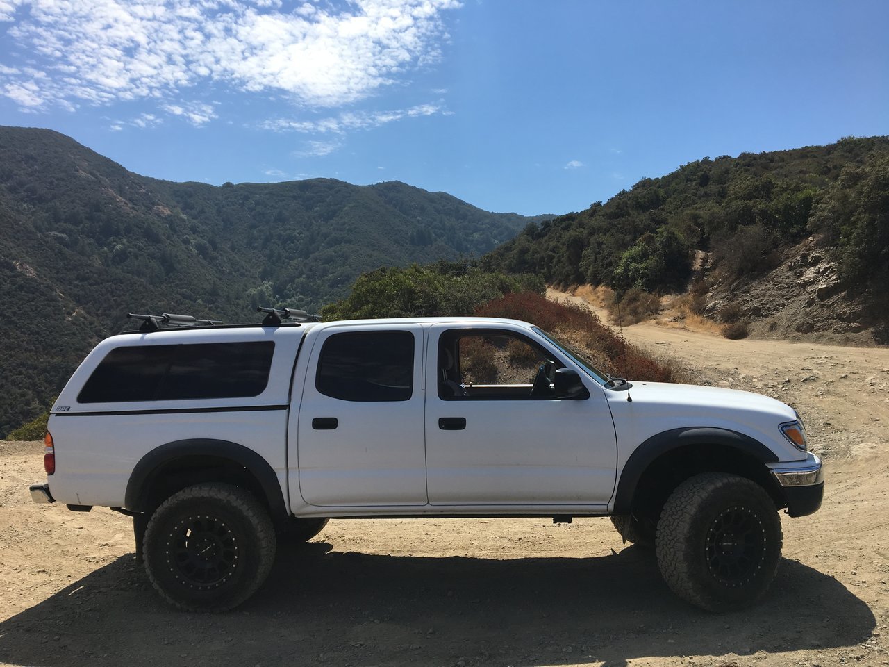

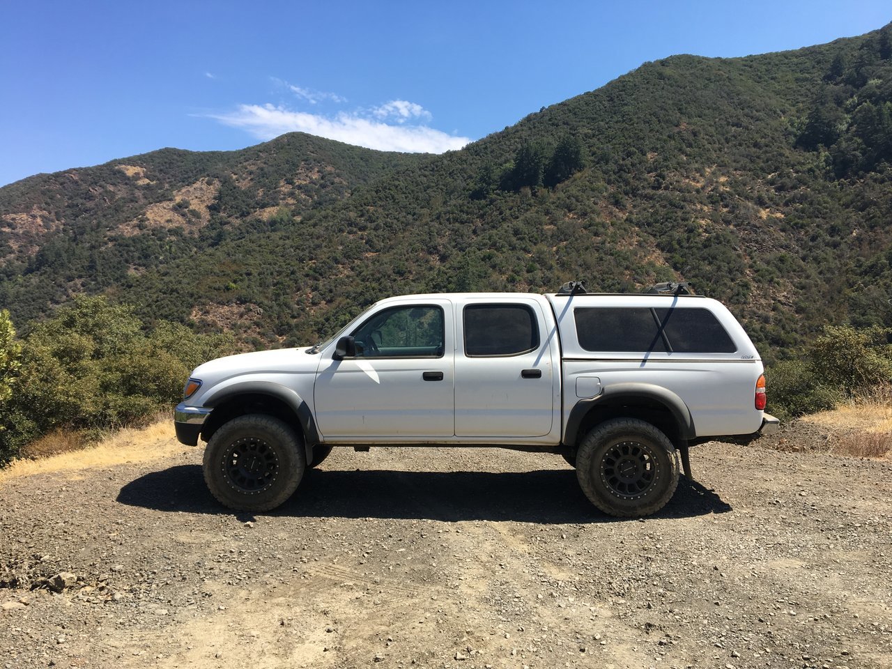

    Thanks man! Here are some pics. Any advice appreciated.
