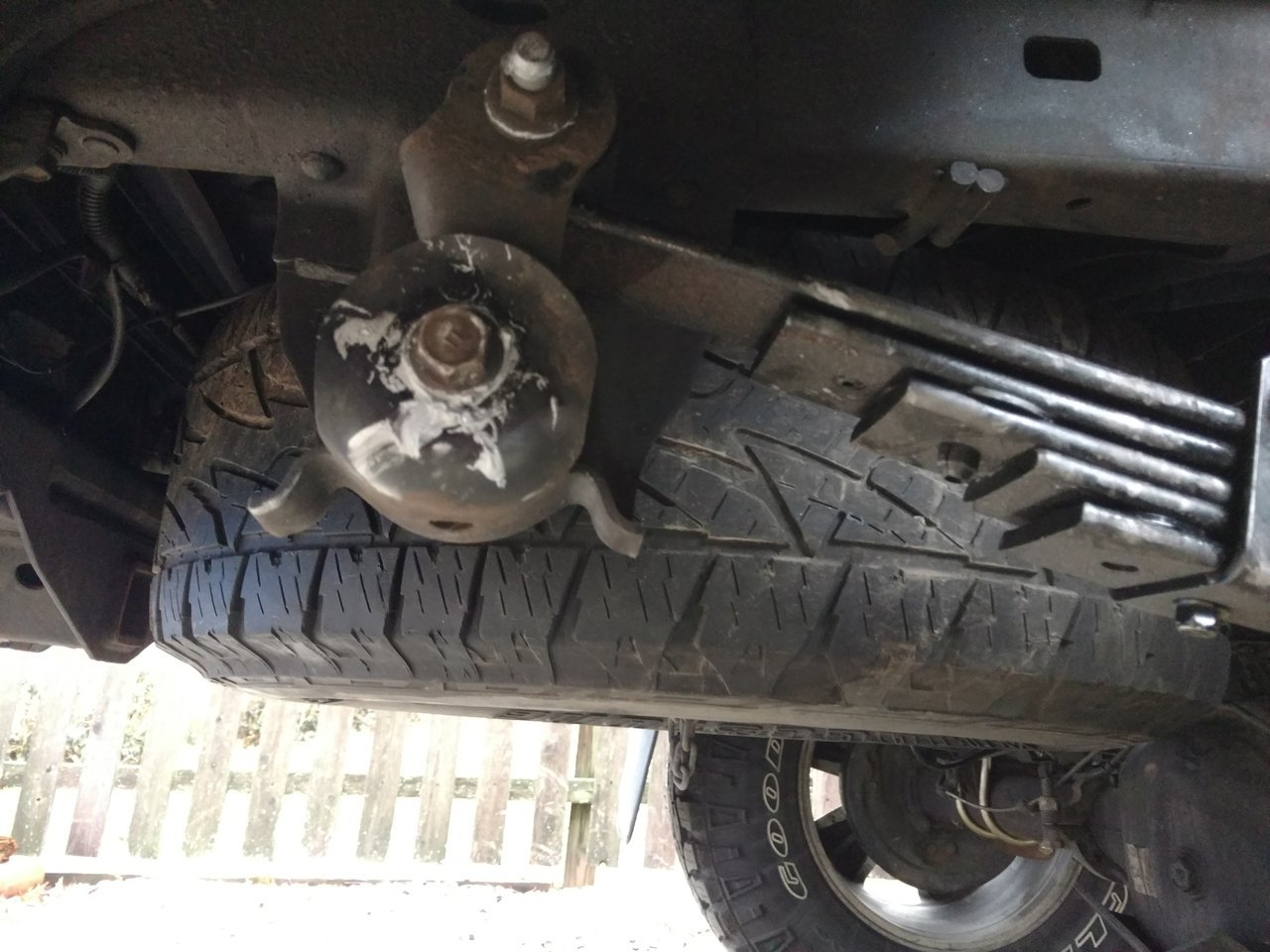

    @jberry813 how worried should I be about only having one leaf going back to the shackle? Truck weights around 6k.
    Is it worth ripping a Dakar pack apart to add another leaf that will go from the front wrap all the way back to the shackle?

    What pack is that.

    The @Blackout14 Panda special from ATS. Rated for 1/2 ton bed weight.

    Compared with a dakar pack it's an amazing upgrade, particularly when I've got a tent and gear back there.
    I'm just worried about that stretch of single leaf going into the shackle.

    Yeah, it's got the rubber ones.

    Yes, you do. Also limit straps.
    I'll replace the bushings with Delrin at some point

    Do you just mean that what looks like a 6" gap between your second leaf and the shackle ? If so, you need some of that gap for clearance IE: When you are at full bump and that shackle is pushed back.
