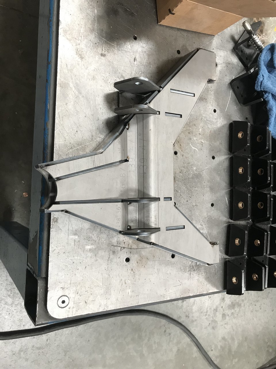

    For all you 2nd And 3rd Gen guys. LSK Suspension is coming out with fully fabricated stock length lower arms. Featuring recessed shock mounts with a bypass mount for more ground clearance. A new trick style arm. CAD designed, Laser Cut and professionally welded. Using a high quality steel and very durable Delrin bushings. Also a additional lower bolt on skid plate can be added on. Also uses a uniball on the end of the arm and bolts to the spindle using a custom billet adaptor. For those interested can email lsksuspension@gmail.com

    Any photos of it installed and/or in use?

    Not yet in use. Will have some installed photos soon.
