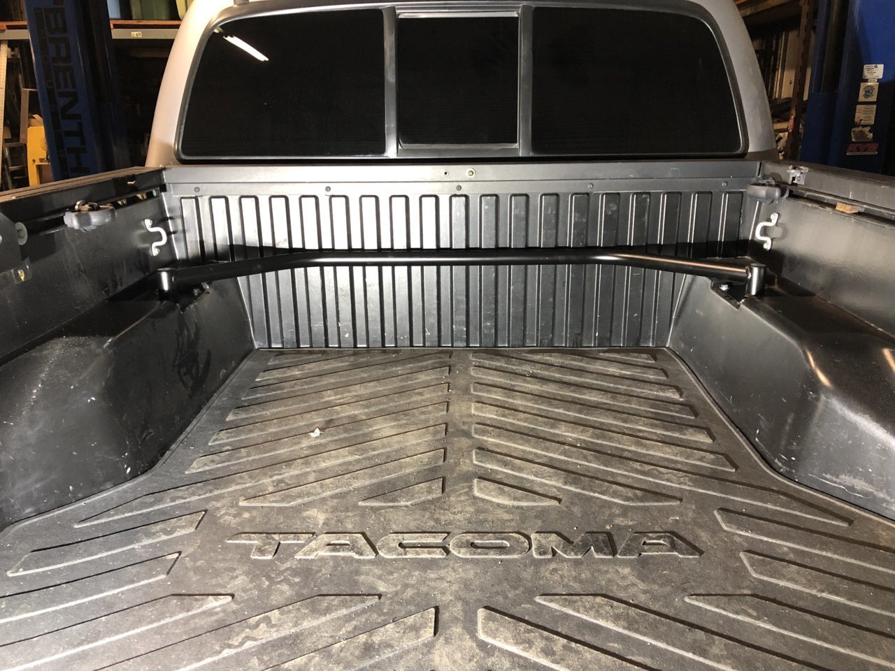

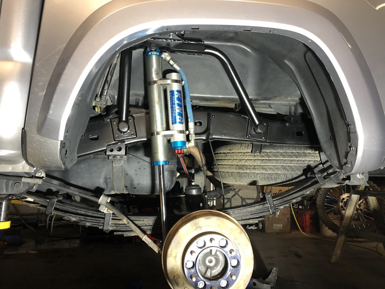

    That looks nice, how much angle is there on the shock side to side?

    Honestly, couldn't tell you. I didn't create the shock hoops for the relocation. Previous TW owner created them had them on his truck but decided to drill into his frame to be a "bolt on." I opted to weld it on this time and had my fabricator create the cross brace.
