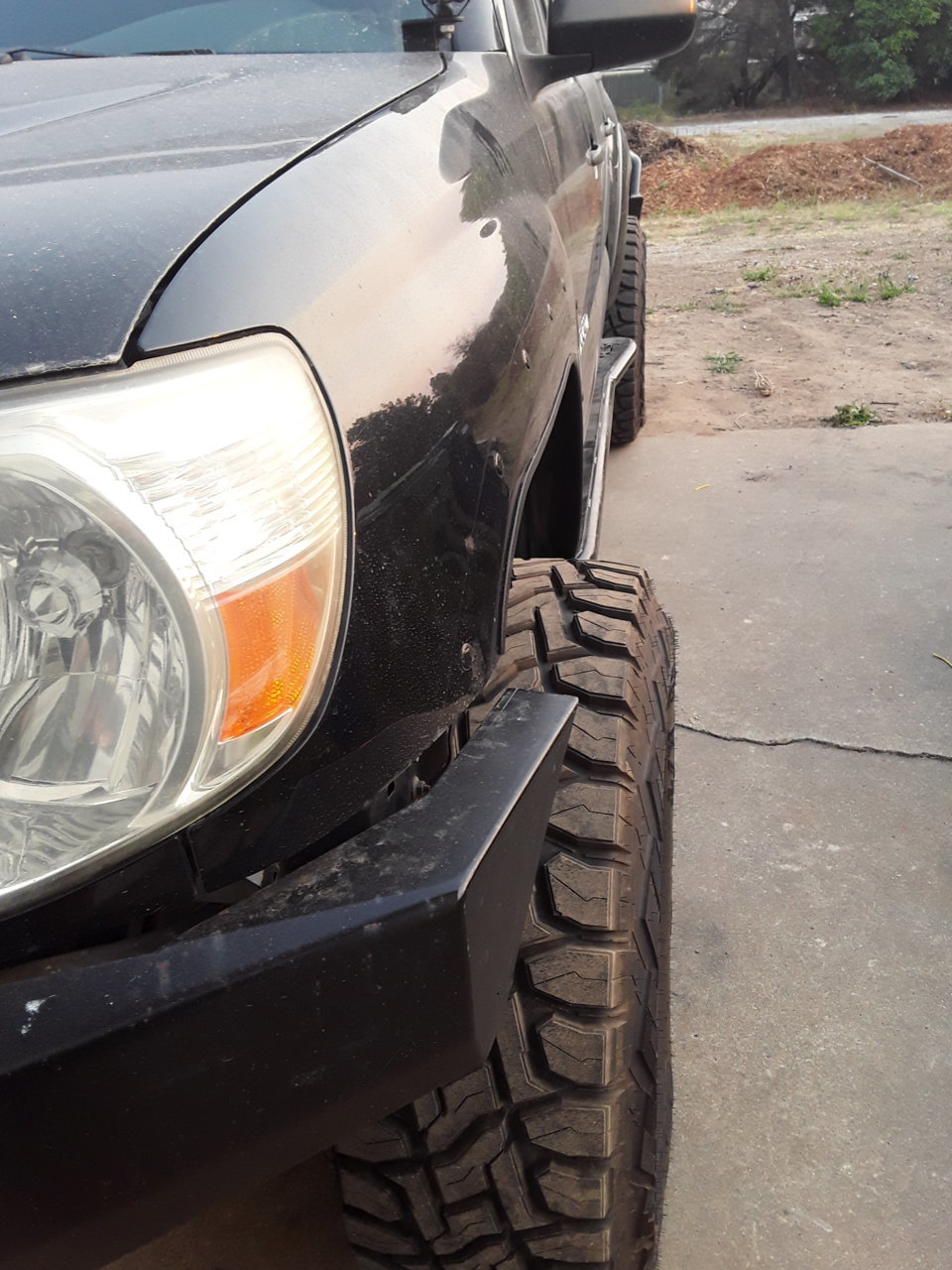

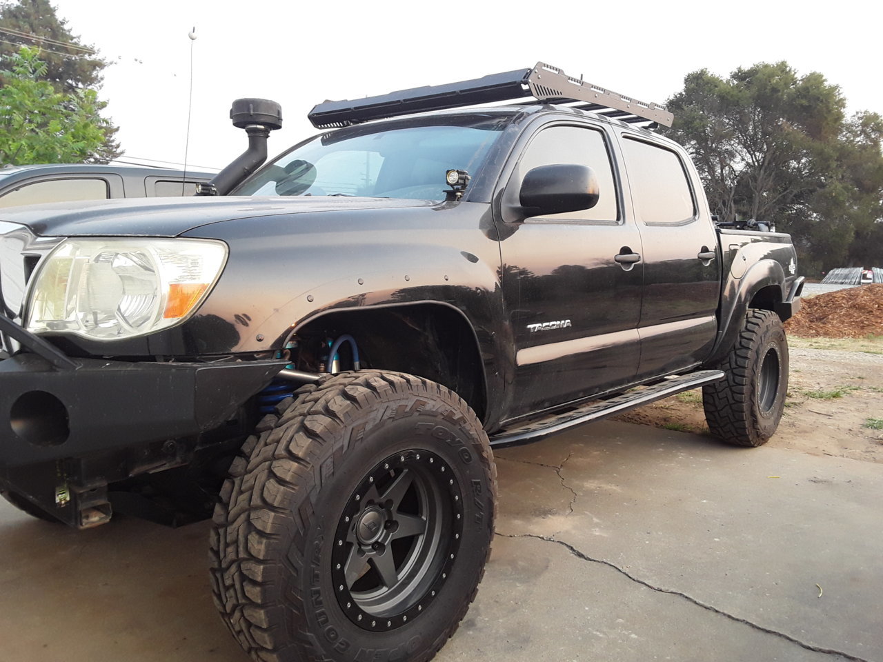

  8. Aug 26, 2020 at 4:40 PM

  9. Aug 26, 2020 at 6:54 PM

    Yea more cab mount chopping is giving me time to practice my welding:welder:. Nothing that a grinder can't clean up.

  11. Aug 27, 2020 at 4:27 AM

  12. Aug 27, 2020 at 3:01 PM
