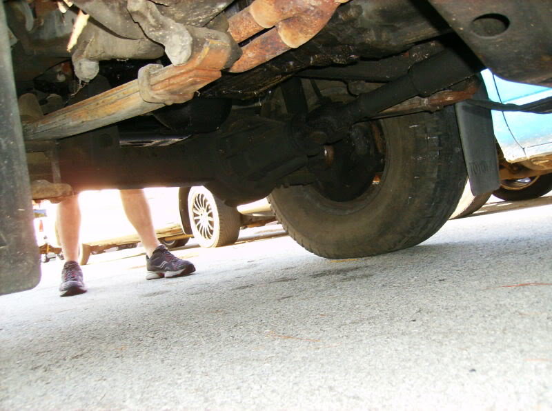

    Well, just bought an 85' Toyota pickup 4x4 last night. It's in rough shape, but it was cheap so I went ahead and bought it. It's the 4 speed manual, with a 2BL carb. Good amount of rust in the bed, but that doesn't bother me to much, it will eventually be replaced with a flat bed. Not currently running, think theres a problem with a fuel filter or pump cuz it will start, but then die out. Leaking oil from the crank gasket, and the carb is leaking a little bit of gas. Other than that, the transmission, transfer case, both SOLID AXLES:D and what not are all solid.
    Initial plans are to:
    1) Get it running (that's always important!;))
    2) Replace all fluids.
    3) Clean everything up, sand off any surface rust and get it painted over, weld patches over rust holes.
    4) Paint it flat black (I think it looks mean on these old yota's!)
    5) New tires.
    Hoping all that is complete by Oct so I can take it wheeling at least once before deploying.
    Post return plans are:
    1) Mild lift, 3-4".
    2) Armor it up for the trail.
    3) Lockers, front and rear.
    4) Flat bed.
    5) Wheel it up!
    Start off pictures:

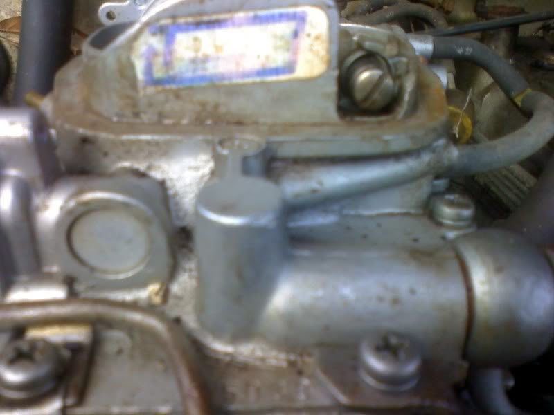

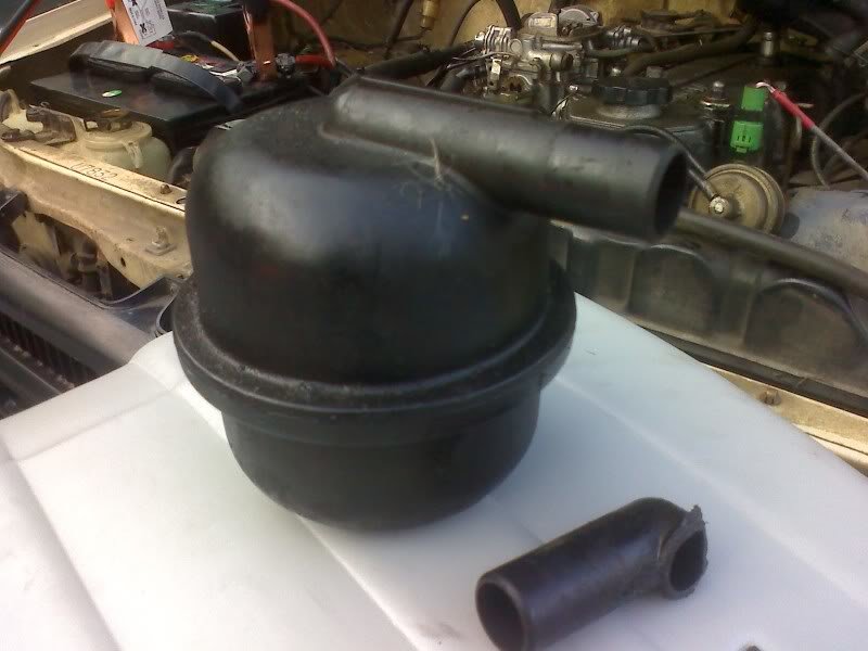

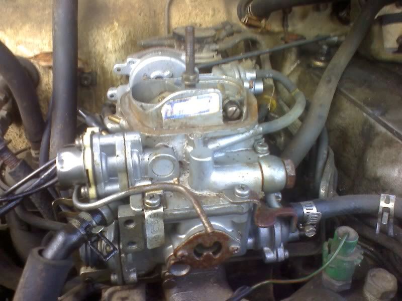

    Could use some help in identifying what this part is for: :confused:
    Was supposed to be attached here but as you can see, its broken:

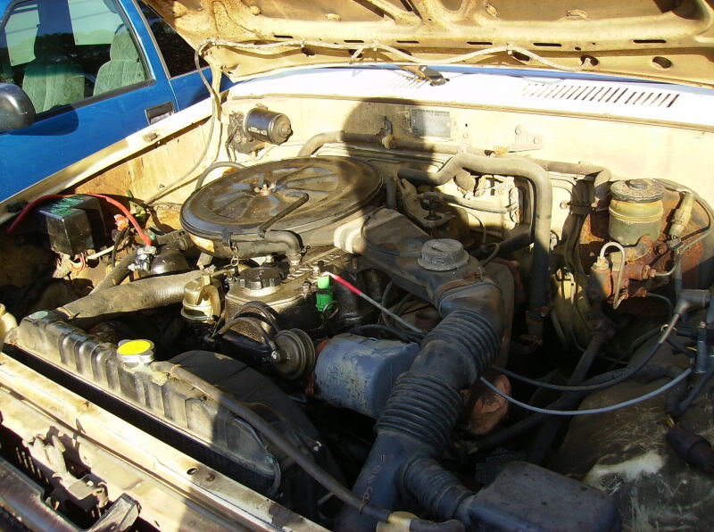

    And if anyone could identify this as the stock aisin carburetor (From my research, I think thats what the stock carb is, if not I humbly bow to your greater knowledge of old toyotas!:bowdown:) it would be appreciated!
    This build is going to be a big learning experience for me, I've never had to do much work beyond basic maintenance on vehicles before, so it's my first time getting into some more complicated stuff.

    Cat-Back, weather techs, ipod and sisuis Old 04 Taco: 5100s At all 4 corners set at 2.5", Toyotec AAL, Gibson cat-back, Deck plate mod, 20% Tint on fronts, 10" Kicker Comp sub, Sirius radio, Bud Built Skid, Pro Comp 8069 Wheels
    Nice truck. I think the broke plastic thing is a choarcol canister. Its for emitions.

    The plastic can has something to do with the pulse type air injection system. Air injection usually means you have a smog pump, not on this motor.

    Don't think so, theres another canister that I believe to be the charcoal canister, will take more pictures tomorrow.
    It's going to be mostly an trail rig. May end up driving it to work, since I have a very short drive, to try and save pointless miles on the taco. (live on base, its about a 4 minute drive to work:rolleyes:)
    Hmmmm, so i could plug that piece that's still on the motor, and it wouldn't matter?

    And that is definitely a stock 22r carb. That little window on the front will let you see the fuel level in the carb bowl. If you still have fuel in there when the motor stalls out, then the fuel pump is okay. I can tell you from experience that any significant vacuum leak on these will cause it to rev up quickly when started, then stall out. I seem to remember there being a large vacuum line you had to remove from the intake in order to remove the air cleaner. If that one is off, the motor will not stay running.

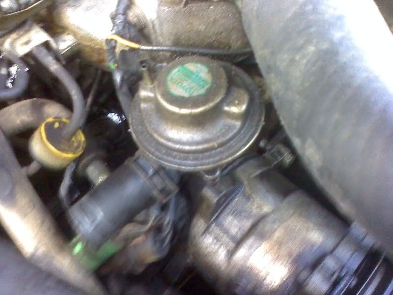

    Yup, it's been a few years since I've worked on one of these, but if memory serves me, you can just plug that off with no issues. Should be able to follow the plumbing for it over to the exhaust manifold. If that's where it goes to, then no issues.
    The egr valve is bolted to the head just behind the carb on the passenger side. You don't want to mess with that, the motor will run way to lean without it and will ping like crazy.

    Thank you! Guess I'll order a rebuild kit, and learn how to do that soon! Interesting tip there, never knew that. Guess I'll have to check. Replaced the fuel filter hoping that was the problem, but I'm pretty sure it's the pump now.

    Looks like I'm going to have to get a new carburetor, the valves at the top won't function properly, and it's also missing the idle compensator, which is not a piece that you can buy anywhere. I'd like to get a Weber Redline series, but it is a lot cheaper to go with a rebuilt Aisin and get the core charge back as well, so that will probably be where I go with it, depending on how open my wallet is feeling the day I order!

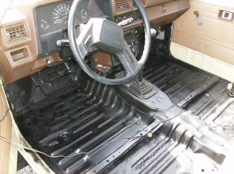

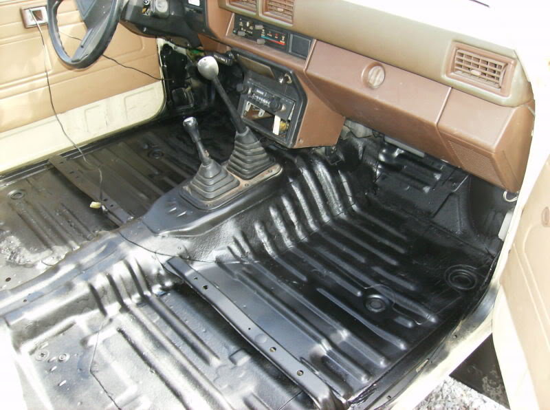

    Waiting on a new carburetor to come in the mail, so I did some a little bit of interior work. Stripped everything off of the floor (extremely simple when it is just a bunch seat, some seat belts, and a rubber floor mat!), cleaned all the dirt off the floor and sprayed in some truck bed liner. Looks pretty great! Also dropped the front skid plate, and the gas tank skid, and I'm gonna drop the gas tank today. Going to bring those over to the auto hobby shop on base and drop them in a solvent tank. Also took the mirrors, and the wipers off, going to sand the rust off and spray paint them black. That's probably all I will get done for a few weeks. Headed off to Wyoming for a week for training, then gonna take some leave and go home.
    After I get back from that, I will have the new carb, and I'm going to replace the spark plugs, wires, distributor cap, and battery. Change the oil, and see if she'll fire up!
    Forgot to take a picture before starting to spray, but both floorboards are in excellent condition:D

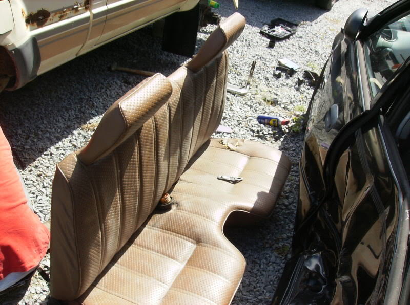

    Bench seat is in all right condition, has a hole going on the drivers side.
