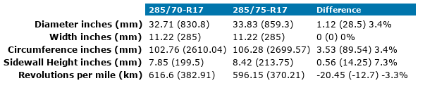

    dude guys run 35s with a 3" lift...just depends on how much you wanna cut and trim I suppose...here's the difference between the 2...
    from the online tire size calculator

    Its a **** hair under a full 33"
